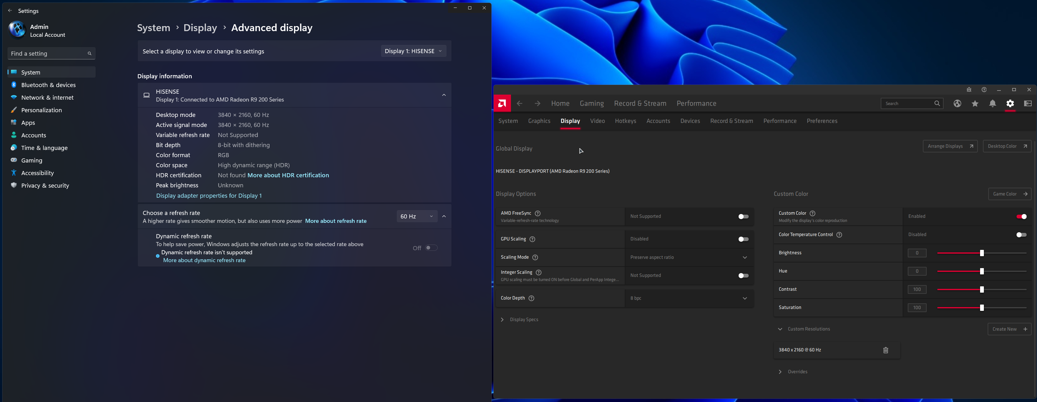

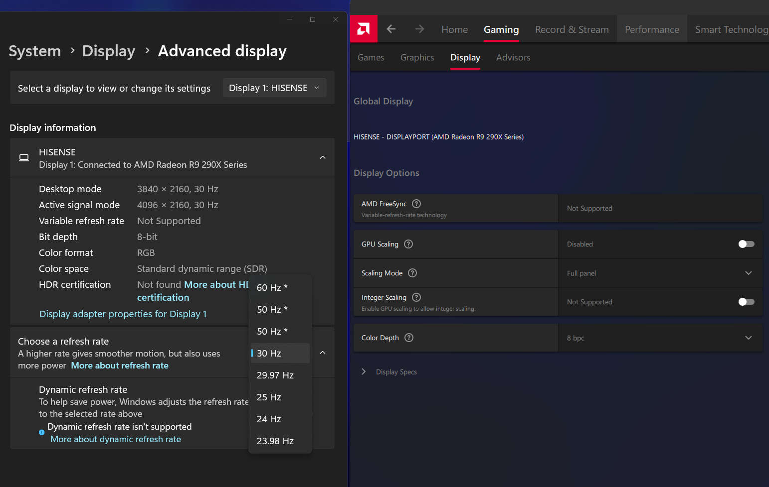

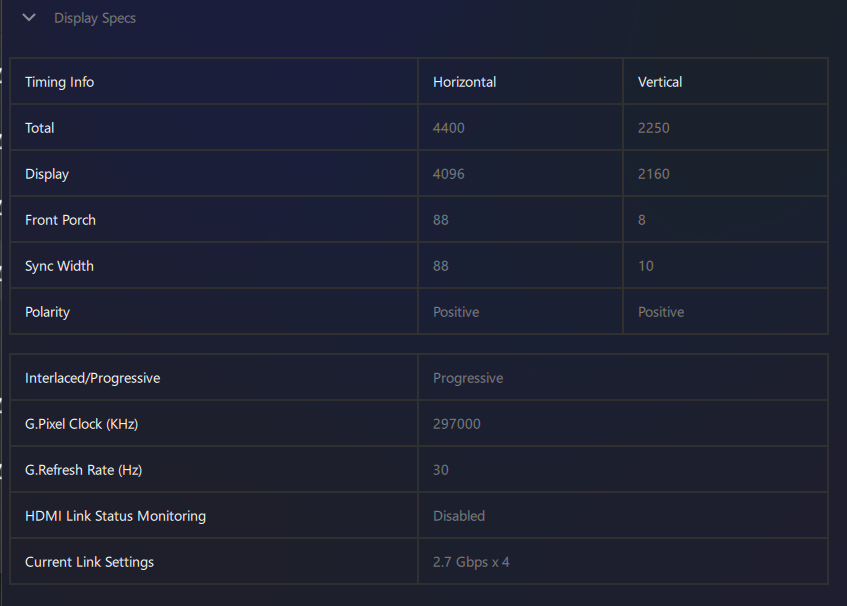

I bought the plugable adapter & still no 60hz 3840x2160 & the driver is acting funny, with active signal 4096x2160 only reporting interlaced beyond 30hz & defaulting to 1440p60 when setting it to 60hz *
By the way on the same display, I get 3840x2160@60p on rx 5600 xt no issues with the same HDMI 2.0 cable.
Thanks

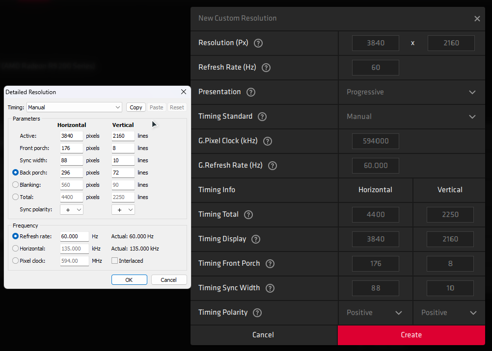

*Update* Had to set custom resolution in amd radeon settings, done & done.
CRU is missing "Timing Display" was set to 4096x2160, is why it had an active signal of 4096x2160, so had to dial it back to 3840x2160 "Timing Display" in Radeon Settings.
@ToastyX Need to add the "Timing Display" feature to CRU. Unless, it's hidden somewhere else?

(04-01-2025 08:18 PM)chris89 Wrote:  I bought the plugable adapter & still no 60hz 3840x2160 & the driver is acting funny, with active signal 4096x2160 only reporting interlaced beyond 30hz & defaulting to 1440p60 when setting it to 60hz *
Thanks
Active is the same as timing display. CRU only deals with active resolutions. CRU does not create scaled resolutions.
The Windows display settings will try to avoid changing the active resolution by scaling lower resolutions to the current active resolution, so if the resolution was set to 4096x2160 and you change the resolution to 3840x2160, it will scale 3840x2160 to 4096x2160 instead of changing the active resolution. To avoid this, you need to set the resolution in the advanced display settings > display adapter properties > list all modes.
You shouldn't need to add a custom resolution. The TV should already define 3840x2160 @ 60 Hz if it's supported, so it should already be listed in CRU. If adding 3840x2160 @ 60 Hz as a custom resolution through Radeon Settings works, then AMD's driver is not working correctly because you shouldn't have to do that. I don't know if AMD broke something at some point because I know this used to work correctly. Do not use the patcher with DisplayPort. Does the same thing happen with the Insignia adapter?

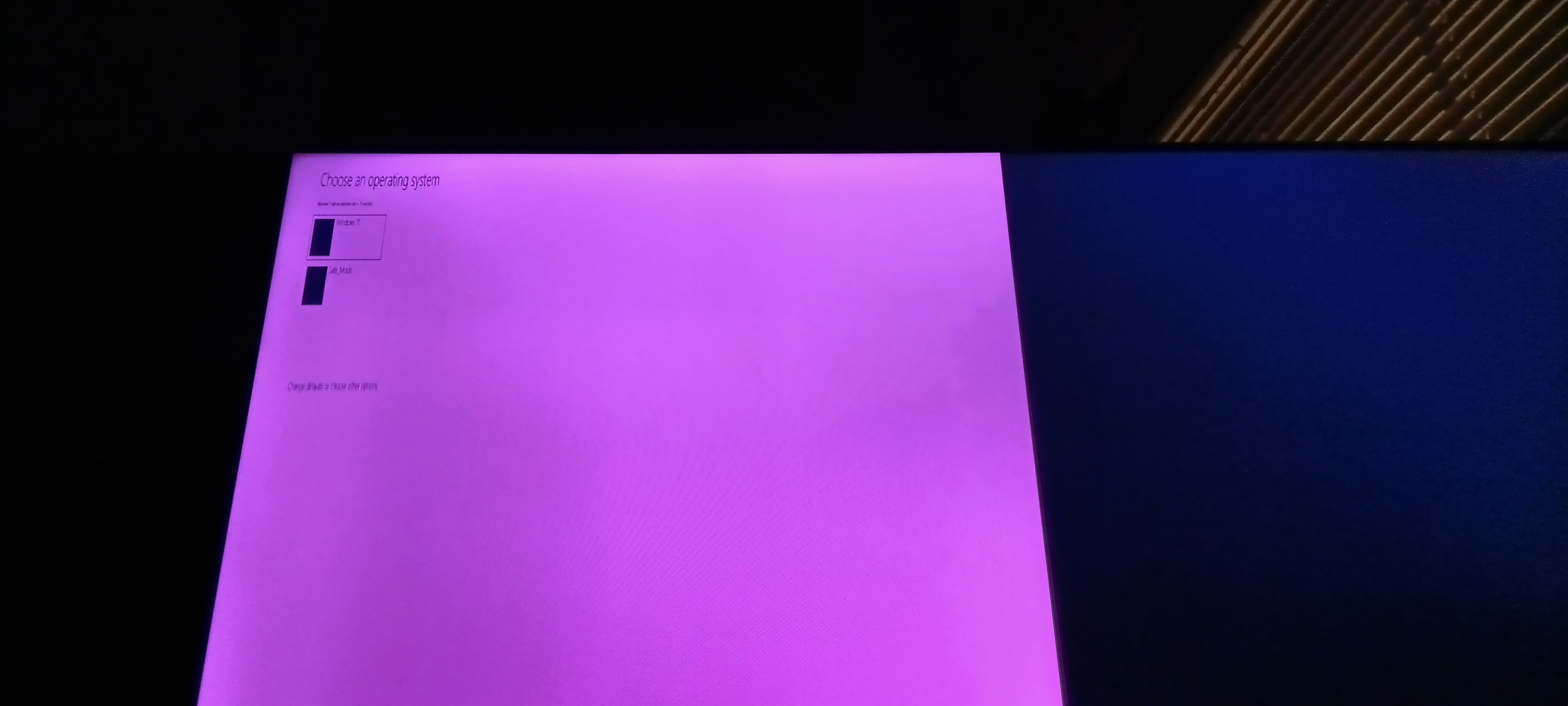

What do you think about this issue? It's normal in windows but at the bootmgr, it's like this.

You said, active is the same as timing display, so may i ask where is this "active" you speak of in cru? Oh okay, it didn't work the same as Radeon Settings Timing Display.
