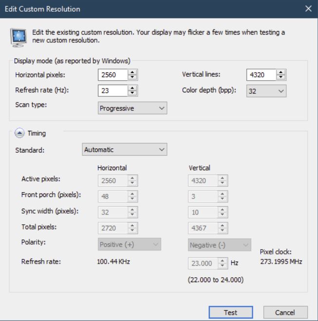

Hey I'm trying to use this utility to make a custom EDID for a very strange LCD screen but it seems to be preventing me from entering the screen details.
The screen is a 10.1" 8k monochrome LCD from a 3D printer with a HDMI adapter board. Unfortunately the HDMI adapter board doesn't include a correct EDID so the screen doesn't 'just work'. The screen is very strange because being monochrome it maps the RGB channels from the HDMI feed to physical pixels, essentially 'stretching' the image by three times in the horizontal dimension. This reduces the bandwidth over the HDMI cable by a factor of three which makes it possible to drive such a high resolution screen over normal HDMI 2.0.
I've attached the settings I need to use when making the EDID. When I try to make an EDID in the CRU with these settings it goes red when I try to enter the 4320 pixel horizontal resolution and won't let me continue, even though that is indeed what this screen needs to be.
Is this a hard-coded limitation of the utility, or am I able to bypass this limit somehow?
05-18-2025, 11:02 AM
Post: #9098
(05-18-2025 02:14 AM)AndrewB Wrote:  Hey I'm trying to use this utility to make a custom EDID for a very strange LCD screen but it seems to be preventing me from entering the screen details.
You should really read the first post before using this software.
