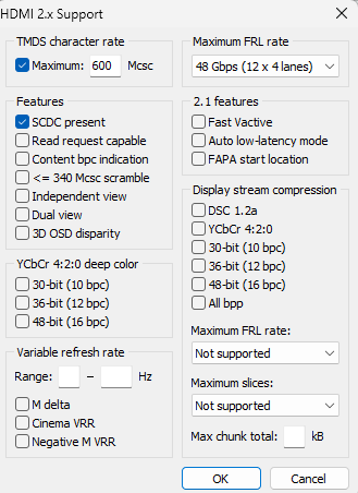

Hi Toasty, I encounter this for the first time, is it normal? when disabling dsc, the block with hdmi 2.1 looks like this. If I understand correctly, when disabling dsc, all features hdmi 2.1 are also disabled, are they somehow related? Monitor msi qd-oled x28, ultra high speed certified hdmi 2.1, 48gbs port.

(06-23-2025 11:16 AM)ArtMov Wrote:  Hi Toasty, I encounter this for the first time, is it normal? when disabling dsc, the block with hdmi 2.1 looks like this. If I understand correctly, when disabling dsc, all features hdmi 2.1 are also disabled, are they somehow related? Monitor msi qd-oled x28, ultra high speed certified hdmi 2.1, 48gbs port.
No, they're not related. None of the features require DSC. That's up to the monitor. VRR seems to be disabled.
