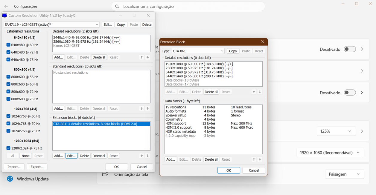

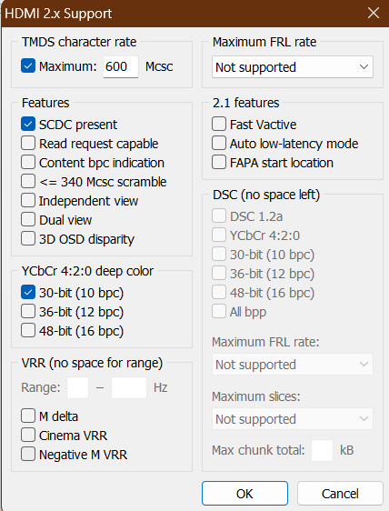

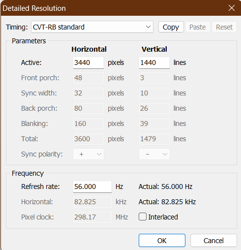

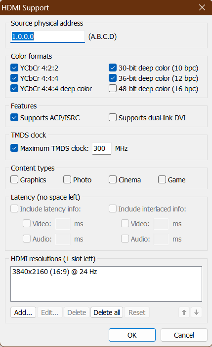

12-09-2025, 06:37 PM (Last edited: 12-09-2025, 09:23 PM by marcosxsilva)
Post: #9326
Hi ToastyX
I'm trying to configure the following environment:
- Samsung WQUHD Monitor 34" (LC34G55T) - Firmware is up to date!
- Dell Inspiron 15 3530 - Core i7 1355U
- Intel Graphics UHD P750 (Intel® Graphics Driver 32.0.101.7082 (whql certified) - Dec 8, 2025
- Video output: HDMI 1.4
- Windows 11 64 - 25H2 (26200.7171)
I'm trying to reach the top resolution I can: 3440x1440 at 60Hz ... but Dell limits it to 1920x1080!
Until few days ago, I was using an old driver version (30.0.101.1692), which allowed the 3440x1440@60 (HDMI 1.4) resolution. I had an update from Windows/Dell this morning and the option for this resolution disappeared, even from old driver. I've checked the Events in windows, there were some instances of updates, but not further details. I notice a lot of errors (Event Viewer), below.
I run a clean driver install to latest version (32.0.101.7082) and then I tried CRU 1.5.3. I followed the CRU instructions for my configuration. I've used CVT-RB for timing. I also tried CVT-RB2 and manual set.
Well... even following the correct steps it's not enabling the 3440x140 resolution.
Any clue or hint to re-enable 3440x1440?
Or... Did Dell find a way to block EDID edition?
Thanks in advance!

(12-09-2025 06:37 PM)marcosxsilva Wrote:  Hi ToastyX
Thanks in advance!
Intel limits HDMI 1.4 to 300.99 MHz pixel clock, but GPUs that support HDMI 2.0 should support up to 340 MHz pixel clock. The new driver must have changed the limit for some reason. You'll have to ask Intel support about that. Installing the older driver should work, but Windows will automatically update to the newer driver, so you would have to roll back the update in Device Manager. The errors are unrelated to the actual driver. They are from some other component such as the control panel.
You might be able to get it to work with the newer driver by adding an HDMI 2.x data block in the CTA-861 extension block. If that doesn't work, then try adding a lower refresh rate within the pixel clock limit such as 56 Hz.
12-10-2025, 10:16 PM
Post: #9328
(12-10-2025 04:20 PM)ToastyX Wrote:
(12-09-2025 06:37 PM)marcosxsilva Wrote:  ...
I've cleaned up drivers (using DDU in Safe Mode) and did a clean driver install using old version.
Old driver -> Limited to 1920x1080(60) -> Tried CRU using your recommendation -> Still limited ... Remark, even after restating driver (I tried both restart and restart64), the * still remains in CRU
Then.... DDU again and now tried the newest driver, but results were the same..
In time, I also tried HDMI data in CTA-861 ext block... no effect. In all cases, I tried 60, 56 and 50Hz ... In these scenarios the frequency didn't exceed 300 Mhz (175 lower and 285 max)
I guess I'm stucked in 1920x1080 in a 34" monitor... Dell notebook with Intel Graphics Driver never more!!!
Thanks anyway!
12-10-2025, 11:20 PM
Post: #9329
(12-10-2025 10:16 PM)marcosxsilva Wrote:  I've cleaned up drivers (using DDU in Safe Mode) and did a clean driver install using old version.
Thanks anyway!
I forgot you wouldn't be able to read the default extension block with Intel, so if you create your own CTA-861 extension block, you need to have both the HDMI and HDMI 2 data blocks, not just HDMI 2. Also delete the default extension block.
12-11-2025, 04:53 PM
Post: #9330
(12-10-2025 11:20 PM)ToastyX Wrote:
(12-10-2025 10:16 PM)marcosxsilva Wrote:  ...
Hi ToastyX. I tried this too... but still not working.
I have attached some screenshots. Did I miss something or something wrong?
Tks once again!
