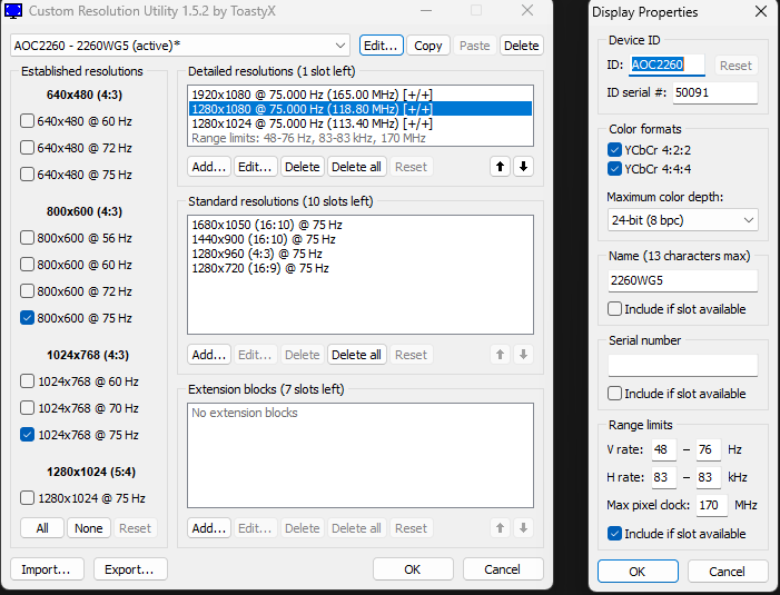

I was trying to overclock my AOC G2260VWQ6, but as soon as I go above 76Hz it shows “Input Not Supported.” I’ve tried adjusting range limits, max pixel clock, and a few other things in CRU. I’m pretty new to this, so I was also following some ChatGPT guidance, but no luck so far. I’m sure I managed to overclock it once before using CRU, just don’t remember exactly what I did. I’ve also experimented with different timing presets, but still hitting the same issue. Do you have any idea what I might be missing? I’m trying to push the maximum Hz possible at 1280x1080 resolution. |

(04-10-2026 05:21 PM)sushank21x Wrote: I was trying to overclock my AOC G2260VWQ6, but as soon as I go above 76Hz it shows “Input Not Supported.”"Input not supported" means the monitor is rejecting the signal. There's nothing you can do on the computer's end to bypass the monitor's limitation. The range limits is information for the computer and does not affect what the monitor does. |

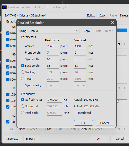

Hello people and toasty! I own a samsung g55c and the dp 1.2 port cooked itself somehow and i do not have warranty so i'm stuck using HDMI 2.0 on this very new monitor.. (specs are: 10 bit @ 1440p/165hz at max capability)
It doesnt even support 10 bit color @1440p/144hz but i use 8 bit with dithering anyways, i've been trying to overclock it using cru back to 165 but i can only hit 149 because the 600mhz pixel clock is the limiting factor. How do i get around this? ![]() ive tried messing around with the timing options but native pc is the lowest so PLEASE HELP. displayport doesnt work for some reason even though the monitor detects it being plugged in? (04-14-2026 10:33 PM)fv101 Wrote: Hello people and toasty! I own a samsung g55c and the dp 1.2 port cooked itself somehow and i do not have warranty so i'm stuck using HDMI 2.0 on this very new monitor.. (specs are: 10 bit @ 1440p/165hz at max capability) |

(04-14-2026 10:33 PM)fv101 Wrote: Hello people and toasty! I own a samsung g55c and the dp 1.2 port cooked itself somehow and i do not have warranty so i'm stuck using HDMI 2.0 on this very new monitor.. (specs are: 10 bit @ 1440p/165hz at max capability)I don't have a way to get around that limit. You won't be able to get 165 Hz except at a lower resolution. You might be able to squeeze in a few more Hz by reducing the timing parameters, depending on what the monitor can handle. If motion seems jumpy, the monitor might be skipping frames beyond 144 Hz with HDMI, in which case there is nothing you can do. Use this test with a camera to verify: https://testufo.com/frameskipping |
