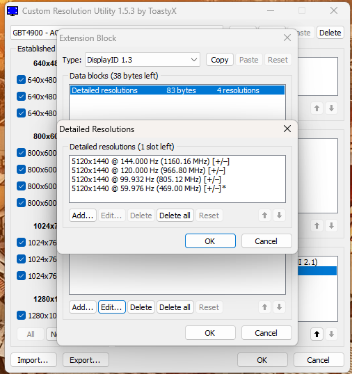

Because of pass-through mode on the SM11 not working, we flashed a custom EDID on the device and the resolution works great BUT I don't get refresh rates higher than 60 Hz. I tried to amend the "detailed resolutions" in the "extensions" section (DisplayID 1.3), same way as we were able to get the 5120x1440 resolution but this does not work with refresh rates.
Has anybody ever experienced something like that?
I'd be grateful for every push in the right direction.
[EDIT]: I should add that the refresh rate of 144 Hz pops up in the selection menu on Pauls testbench but not in my setup. I can't see anything higher than 60 Hz, independent of what I add to the section.
[EDIT]: See the original EDID of the monitor with all detailed resolutions here     . I assumed, if I'd copy them over to the actual EDID flashed onto the devices, these resolutions and refresh rate combinations show up in the display panel, but they don't.

Use CRU to export a file and post it here.

Thank you, here you go:
- The original EDID of the monitor connected via HDMI directly and exported:
.bin  AORUS CO49DQ.bin (Size: 384 bytes / Downloads: 143)
- The EDID I got from Blustream to make the 5120x1440 resolution work, through the signal processor:
.bin  5120x1440P EDID.bin (Size: 256 bytes / Downloads: 127)
- The EDID, with 144 Hz based on the one provided by Blustream. Doesn't matter what refresh rate I add here, it stays on 50 Hz:
.bin  5120x1440 EDID 144.bin (Size: 256 bytes / Downloads: 116)
I hope this helps!
