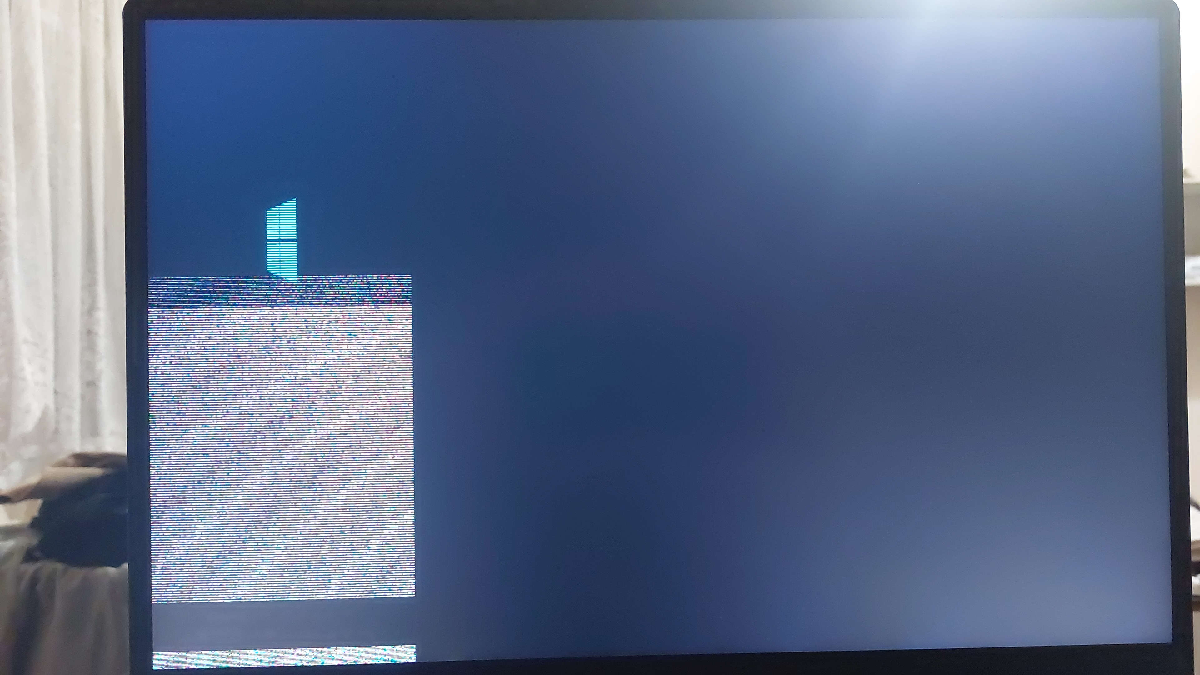

Hi everyone!
Before anything, thank you so much ToastyX for everything you do, I've been using CRU for a couple of years and it's been very useful on older monitors.
I have a question I think only the people over here might help with or at least explain its cause, I think it's beyond the scope of CRU because it happens before Windows boot.
I have a Lenovo LOQ 16APH8 with an RTX 4060 + AMD iGPU, my original display panel was B160UAN05.A 1920x1200 with G-Sync 144Hz, I upgraded it to a different panel N160GME-GTB 2560x1600 240Hz that only supports VRR.
This new panel is not supported by Lenovo, but it works perfectly once Windows is loaded, no issues whatsoever.
The issue happens when I switch to dGPU-only mode in BIOS, in the pre-Windows boot and in BIOS, the display looks distorted and static-y like the old TVs (see the video I attached), once Windows login page is loaded, the display is working perfectly as intended.
This issue is not present when I'm on Hybrid-mode/Switchable graphics, it only happens on dGPU-only mode.
My first thought was that my new panel's EDID data is probably corrupt or messed up, but I compared it to dumps from linux-hardware dot org for the same model of course, and it's an exact match, so nothing wrong there.
I'm now suspecting my Nvidia's vBIOS GOP version needs an update or something, I have no idea what's this, I used AI to try to troubleshoot this, could be wrong.
I looked up laptops with my exact GPU and new panel, found one Acer-PHN16-72, got its vBIOS and it seems to have a newer GOP version 7.0.0.19 compared to mine 7.0.0.13, I should note that this laptop I found has G-Sync even though N160GME-GTB doesn't support G-Sync.
Any ideas guys?
Link to video
.bin  N160GME-GTB.bin (Size: 256 bytes / Downloads: 13)

(10-16-2026 07:27 PM)Qattos Wrote:  Hi everyone!
Any ideas guys?
That's happening because the BIOS is using the wrong resolution, and laptop panels don't have scalers, so it doesn't display correctly. The graphics driver in Windows reads the EDID, so it uses the correct resolution, and lower resolutions are scaled by the GPU. I don't know why the BIOS would only use the wrong resolution with the dedicated GPU though.

(10-17-2026 10:58 PM)ToastyX Wrote:  That's happening because the BIOS is using the wrong resolution, and laptop panels don't have scalers, so it doesn't display correctly. The graphics driver in Windows reads the EDID, so it uses the correct resolution, and lower resolutions are scaled by the GPU. I don't know why the BIOS would only use the wrong resolution with the dedicated GPU though.
UPDATE:
I went ahead and flashed the Acer vBIOS I mentioned earlier, and now my issue is solved, my laptop is working perfectly fine after stress testing the gpu, I have yet to test the only HDMI port on my laptop but I don't use it that much anyway.
OLD post:
Thank you so much for clarifying this.
I assume there's not much I can do to resolve this? Besides modding Nvidia's vBIOS, even this seems impossible with how much Nvidia locked down their vBIOS.
I have a CH341A programmer to dump my BIOS file but I wouldn't know what to mod even if I was willing to risk it.
Either way, thanks again.
