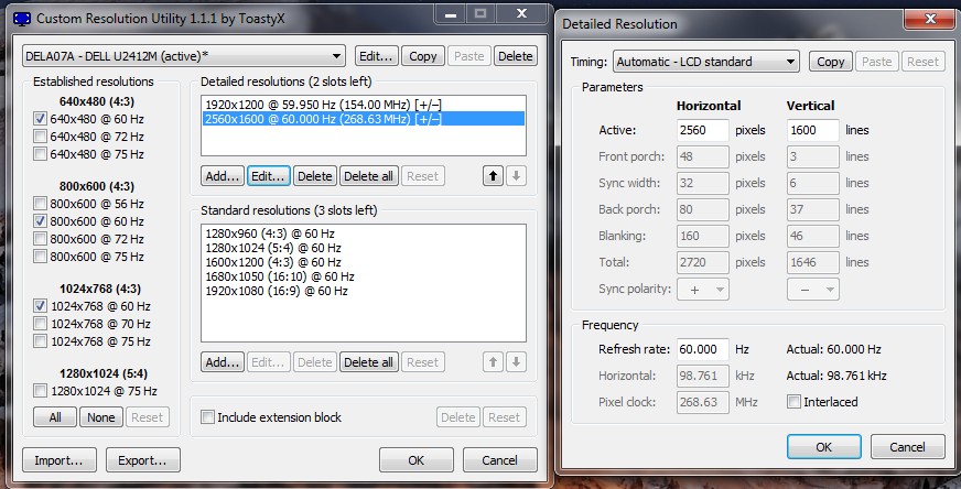

Greetings,
I am currently trying to add a working custom resolution to my system using CRU. I am running a Radeon 280x with catalyst 13.12 and a Dell U2412M monitor. Sadly after setting up the resolution and rebooting, I can not set the resolution in the system. The monitor says that the current input timing would not be supported. I tried uninstalling monitor drivers, which did not help. Also, alternative DVI mode is activated in AMDs CCC. Attached is a picture of my settings

(03-17-2014 02:20 PM)Jaffi Wrote: I am currently trying to add a working custom resolution to my system using CRU. I am running a Radeon 280x with catalyst 13.12 and a Dell U2412M monitor.You're trying to set a resolution that the monitor doesn't support. Furthermore, you're sending a resolution that requires dual-link DVI to a single-link DVI monitor. |

(03-17-2014 05:47 PM)ToastyX Wrote:(03-17-2014 02:20 PM)Jaffi Wrote: I am currently trying to add a working custom resolution to my system using CRU. I am running a Radeon 280x with catalyst 13.12 and a Dell U2412M monitor.You're trying to set a resolution that the monitor doesn't support. Furthermore, you're sending a resolution that requires dual-link DVI to a single-link DVI monitor. You are right, I now tried 2.880 x 1.800@60Hz. But this resolution I can not choose in windows or games, why is that ![]() Also, to completely reset the modifications from CRU, is it enough to just hit the reset button in the top right corner for the active display? Thanks very much! |

(03-17-2014 07:34 PM)Jaffi Wrote: You are right, I now tried 2.880 x 1.800@60Hz. But this resolution I can not choose in windows or games, why is thatYou are running into pixel clock limits. Dual-link DVI is limited to 330 MHz pixel clock and single-link DVI is limited to 165 MHz unless the driver is patched. You will not be able to get 2880x1800 @ 60 Hz with a single-link DVI monitor. (03-17-2014 07:34 PM)Jaffi Wrote: Also, to completely reset the modifications from CRU, is it enough to just hit the reset button in the top right corner for the active display?You can use the "Delete" button at the top-right corner to delete the override for one monitor, or you can run reset-all.exe to delete all overrides. That will completely remove any modifications. |
