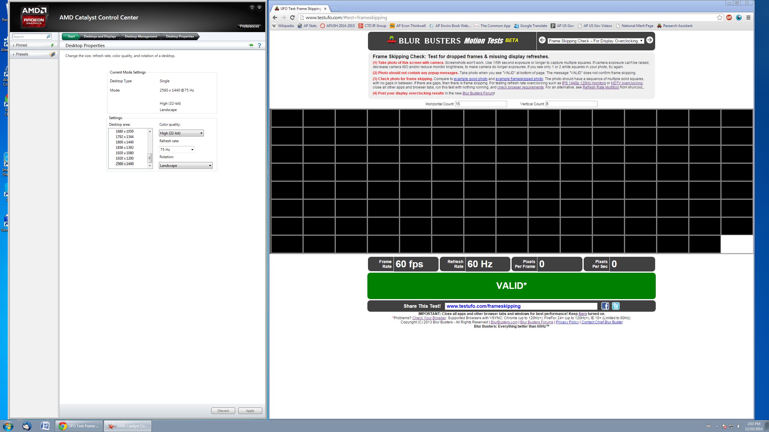

Hey, I just got a QX320QHD. It isn't overclocking, and people at overclock.net and the manufacturer have suggested it should.
Anyway, I got my new QX320QHD, I plugged it in, great monitor, very nice colors. I connected it with the dual link DVI that came in the box. The whole reason I got it was so I could overclock it, as per the widely circulated screenshot on Amazon here (bottom photo on the left sidebar): https://www.amazon.com/dp/B00KVZMUYI/?tag=mtests-20#ad
I actually got the monitor here because lower price, I am 99% sure there's no difference as they are the exact same model: https://www.amazon.com/dp/B00O0UTCPA/?tag=mtests-20#ad
I got the monitor, loaded up CRU, added custom resolutions, the first with 85 hz 1440p and the second with 720p 100hz (to see if lowering resolution would allow higher refresh). I also removed the pixel clock that's in the AMD drivers. I rebooted, changed the refresh rate in AMD Catalyst Control... and black screen on 1440p 85hz!
I then tried 720p 100hz, and this is what's really strange. It worked. No visible frame skipping, so I loaded up the Test UFO frame skipping [http://www.testufo.com/#test=frameskipping], but it identifies my frame rate & refresh rate as 60hz! I tried a bunch of different resolutions in CRU, including 1440p 65 hz and 720p 65 hz, but every time it still says 60 frame rate and 60 hz refresh. I can provide screenshots tomorrow if necessary.
I have a prebuilt with a i7 4790 and R9 270, and my OS is Win 7 Home Prem. Those shouldn't be the issue unless I'm completely off.
Thanks so much for the help in advance! I really appreciate it!
Edit: screenshot of amd catalyst control saying 75hz while testufo says 60hz.

(12-10-2014 06:40 PM)_alkaline Wrote:  Hey, I just got a QX320QHD. It isn't overclocking, and people at overclock.net and the manufacturer have suggested it should.
If 85 Hz is listed and you're able to set it, then it's working properly and your particular monitor can't handle it for some reason.
(12-10-2014 06:40 PM)_alkaline Wrote:  I then tried 720p 100hz, and this is what's really strange. It worked. No visible frame skipping, so I loaded up the Test UFO frame skipping [http://www.testufo.com/#test=frameskipping], but it identifies my frame rate & refresh rate as 60hz! I tried a bunch of different resolutions in CRU, including 1440p 65 hz and 720p 65 hz, but every time it still says 60 frame rate and 60 hz refresh. I can provide screenshots tomorrow if necessary.
Make sure you're using one of the Aero themes. The UFO test requires desktop composition to work properly, but your screen shot shows you're using the Basic theme, which disables desktop composition.
That would make a lot of sense. I'll test it with Aero this evening when I have a chance. Thanks ToastyX!!

(12-10-2014 08:08 PM)ToastyX Wrote:  Make sure you're using one of the Aero themes. The UFO test requires desktop composition to work properly, but your screen shot shows you're using the Basic theme, which disables desktop composition.
I just tried the Aero theme, and still no results, as you can see in the screenshot. This makes no sense, and if you have any more ideas I would be very grateful! Thanks!

Nvm. Forgot about hardware acceleration. My qx320QHD seems to be capable of 79 hz, if anyone is curious. A bit disappointing as I was hoping for ~90hz, but oh well it's beter than 60hz!
