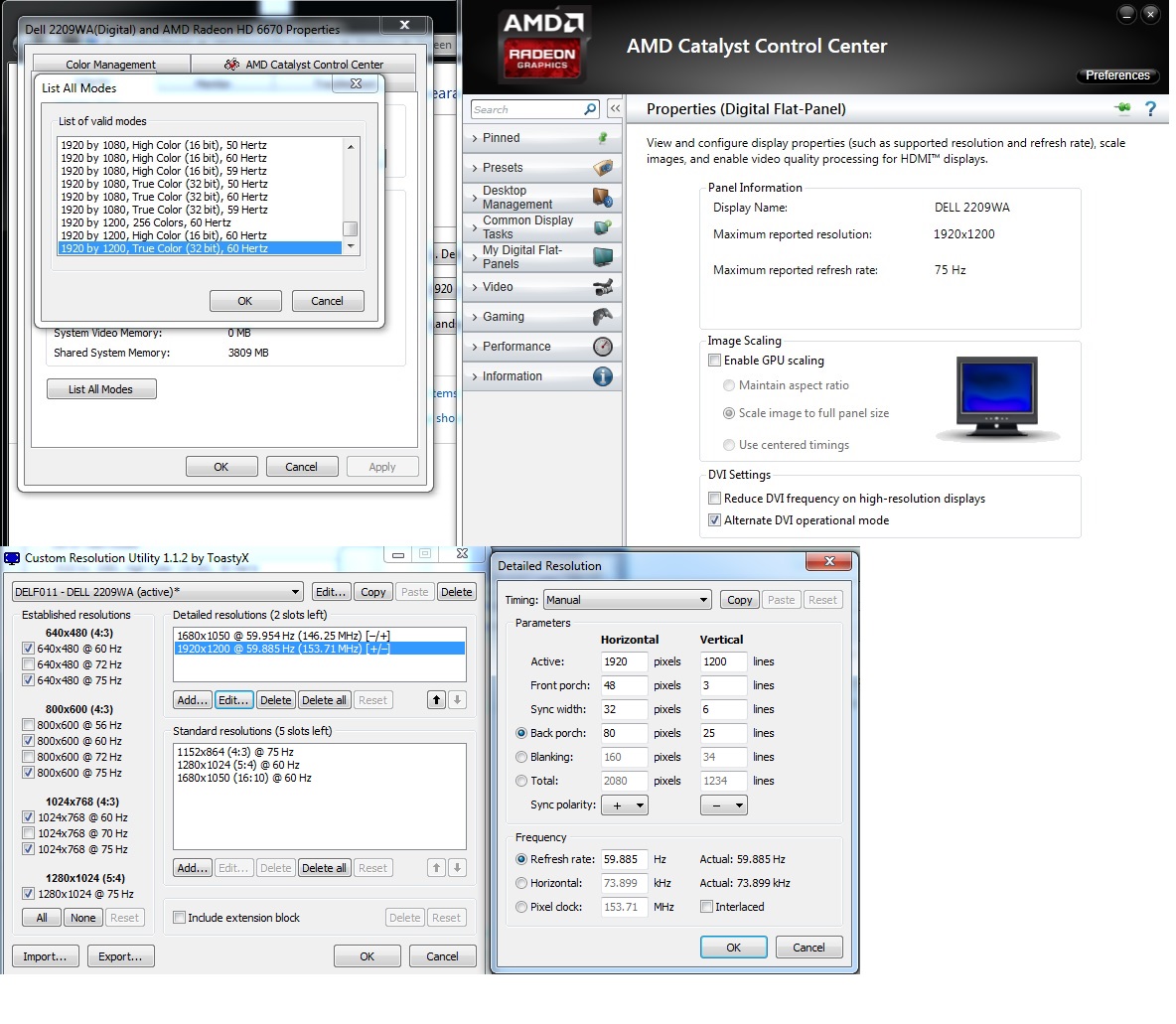

oh brother thanks so much when you answered i was actually editing my post with the gpu scaling thing i missed.
Then what option in that pane do i have to set front porch back porch sync width and refres rate exactly 60hz beside giving exact 1920 1080
The "LCD standard" option should fill those in for you. The 2209WA will accept both 1920x1200 and 1920x1080, but 1920x1080 will be stretched to the wrong aspect ratio.
The GPU scaling option in the driver is for scaling lower resolutions to the native resolution. CRU can't be used to scale higher resolutions down to the native resolution. The video card will send the higher resolution to the monitor. In this case, your monitor will accept 1920x1200 and scale it down itself, so it will work.

so in layman terms Big Grin i dont have to enable gpu scaling (getting it wrong in the first place ) just simple LCD standard ok and reboot. Thanks will post the success news fingers crossed, here goes all or nothing...

here is the result, a bit confusing as reported maximum 75hz but in list mode available 60hz , both for 1920 x 1200 which i got thanks to your fantastic tool Smile, so what refresh rate am i in ?
beside can i do something about anitaliasing as my screen definitely suffering from it, my catalyst set to app managed about it and sample method set to multisampling , standard 3D settings is balanced,Tessellation amd optimzed , Anisotropic filtering app managed ,any thing do i need to tweak here , i know these questions getting related to a specific card,so my question would be based on your experience do you think i need to enhance the refresh rate ?as from the picture doesnt they look a bit aliased from the previous attachment?

(12-11-2014 06:00 PM)network4me Wrote:  here is the result, a bit confusing as reported maximum 75hz but in list mode available 60hz , both for 1920 x 1200 which i got thanks to your fantastic tool Smile, so what refresh rate am i in ?
That's just the maximum at any particular resolution. You have 75 Hz defined for 640x480, 800x600, 1024x768, 1280x1024, and 1152x864.
The monitor is running at 60 Hz. In CCC, check under Desktop Management > Desktop Properties. It should match the Windows screen resolution settings.
(12-11-2014 06:00 PM)network4me Wrote:  beside can i do something about anitaliasing as my screen definitely suffering from it, my catalyst set to app managed about it and sample method set to multisampling , standard 3D settings is balanced,Tessellation amd optimzed , Anisotropic filtering app managed ,any thing do i need to tweak here , i know these questions getting related to a specific card,so my question would be based on your experience do you think i need to enhance the refresh rate ?as from the picture doesnt they look a bit aliased from the previous attachment?
The monitor's native resolution is 1680x1050. Higher resolutions will not look as sharp. There's no point in using a higher than native resolution if you're going to use antialiasing, and the antialiasing options won't affect the desktop. A screen shot is not going to show how the monitor is scaling.
