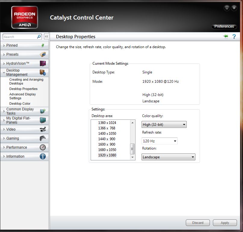

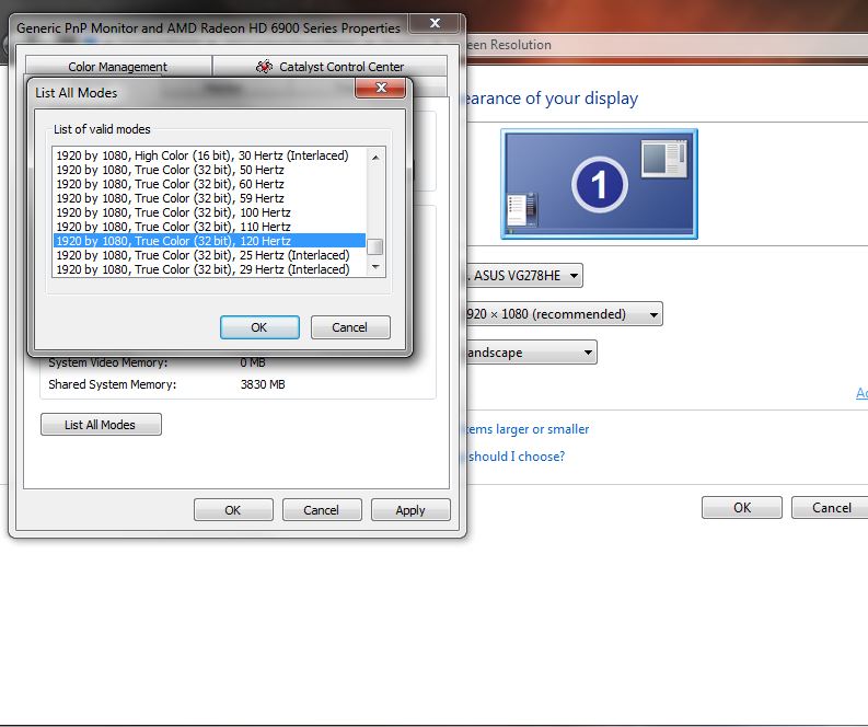

Hello ToastyX.
Thank you very much for this program and for your freetime making this!
I have one problem. I have an Asus AMD hd6950 and the new Asus VG278HE - 144hz lcd monitor.
I removed the locks from all the display ports so now in windows 7 i can use 120hz on my Generic PnP Monitor - using DVI dual link.
But using CRU i cant get to 144hz. i have read and read almost all the posts in this thread and tried almost everything. But i cant get 144hz no matter what i do :-(
Hope u can help or even send me a file if u got the time.
If u can make this work ill donate some $$ Smile
Thank u already!
Tha Kang

AMD cards only have one dual-link DVI port. If your card has two DVI ports, make sure you are using the dual-link port and not the single-link port. You will not be able to get 144 Hz on a single-link port. You shouldn't have to use CRU to get 144 Hz with that monitor. It should already work out of the box.

Yes needed to turn the internal switch on the gfx card! and use the right DVI port! Thanks man ur the shit!!!
Everything works now 144hz Wink
(05-09-2013 08:36 AM)ToastyX Wrote:  AMD cards only have one dual-link DVI port. If your card has two DVI ports, make sure you are using the dual-link port and not the single-link port. You will not be able to get 144 Hz on a single-link port. You shouldn't have to use CRU to get 144 Hz with that monitor. It should already work out of the box.
