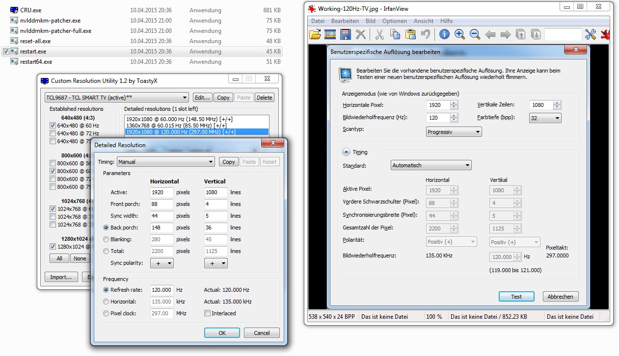

I'd like to post my results and ask for further advice on my TV.
So, I do have an GTX 980, 8mm thick quality HDMI High Speed Cable, and TCL U40S7606DS (4k, HDMI2.0).
I'd like to achieve 1080p120 (btw. 2160p60 are no problem) - I had "some" success using nVidia custom resolution, but I do have skipped frames (actually the half like it's 60Hz). I am not sure which side tricked me (nVidia as some "feature" to let me believe it sends 120Hz, while it has been just 60 - or the TV that said it run's at 120/121Hz but just displayed the half, anyway), yet I'd like to find out if the TV is capable of it.
So what did I test till now you may ask: Using nVidia custom resolution - I did try all the available timings yet the ONLY working configuration was when I tried to set a custom res. out of 1080p60, just set 120 instead of 60Hz and test that. What makes me wonder if really 120Hz are being sent is that it actually uses timing out of 60Hz (when I check while "edit" the saved custom res.). Yet refresh-rates and pixel clock are at double of 60Hz. You can see my working settings for the nVidia custom resolution at the attached jpg file - while you can also see that I tried to set the same values via CRU - and that doesn't work ("No Signal").
In the attached zip-File you can see that the "nVidia (fake?) 120Hz" are actually more like "60Hz" (as just every 2nd frame is displayed). And one weird thing: the TV displays it would be running at 121 Hz. For sure I did also try all the other automatic timings CRU provides - with out success ("No Signal").
All this seems like it can't run at 120Hz, yet I am not about to give up. What I'd like to know: are there other timings I should test (common timings that are known to work) or is there any "overclock-procedure" about which value I should increase in a step by step - overclock test?

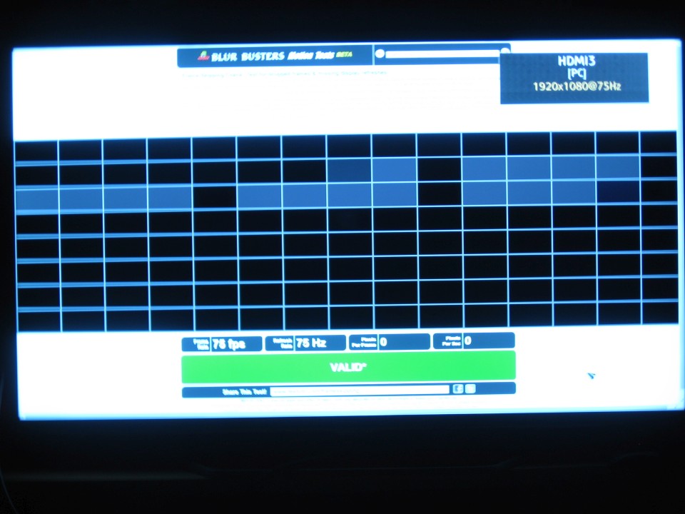

EDIT: Btw. i forgot to say that 720p@120Hz is working (whatever way i try - using nVidia or CRU). I just did some test as I thought "why not testing other frequencies?" Well (just testing "Standard resolution"), 85Hz did result in "No Signal" but 75Hz was accepted but - see yourself in the attached 75Hz Image - skipped frames. -.- Yet I don't know if it's nVidia or the TV but it's likely the last one (or could nVidia send 60 frames but trick the TV to think it would be 75?)
.zip  120Hz-TLC.zip (Size: 189.89 KB / Downloads: 1134)
