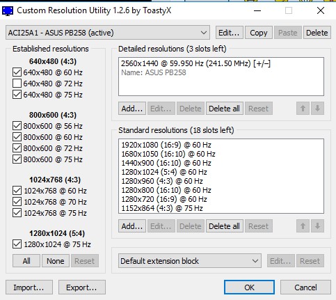

I'm not sure if this is the best of places to ask this question, but I see people asking all over the place and I -think- I narrowed down my problem to the CRU. I'm using the QX2710 Evolution II 1440p monitor and up until recently it had been working fantastically for me. I'm using a Sapphire R9 290 tri-x graphics card and I had successfully overclocked the monitor to ~110 - 115 hz.
Just recently I used drivesweeper (now DDU) to sweep out my drivers and start all over again because all the past updates were clogging up my computer. I reinstalled 16.1 for windows 10 64 bit, but whenever I try to overclock my monitor to 1920x1080 it just gives me a black screen. Even if I leave it at 60 hz, it gives me a black screen whenever I try to switch to it. Every time I try to do the custom resolution from the new amd control panel, it says it's not supported and automatically reverts it.
I can successfully patch my driver with toasty's patch, and if I switch to 1920 x 1080 without using cru it's fine, but as soon as I try to set up a custom resolution, it messes up. I tried the reduced lcd or standard lcd (whichever it was) fix that toasty had put in their little FAQ, but whenever I do that, it automatically reverts to manual timing. So I'm at a loss for what to do. I'm probably missing something very simple. Can anyone help?

Why are you trying to add 1920x1080? The QX2710 is a 2560x1440 monitor without a scaler. It doesn't support non-native resolutions. By adding 1920x1080 using CRU, you're telling the driver that the monitor supports 1920x1080 when it does not. You need to add higher refresh rates at the native resolution, 2560x1440. The driver will automatically add some common resolutions like 1920x1080 as scaled resolutions.

Because there are some games I play that are just too overwhelming for my card at that kind of resolution. I like to tone it down to 1920x1080 for those kinds of games, but when I fullscreen them it messes up my second monitor, which is 1920x1080, and when I do borderless windowed, it just scales up the resolution back to 2560x1440. What I don't get is why it worked before and it doesn't now, you know? But I removed the old custom resolution and switched to to the 1920 one and it looks like the hz stayed. Thanks for the help. Guess I'm just dumb Tongue

The only way it could have worked before is if you added both 2560x1440 and 1920x1080 with GPU scaling enabled, but you don't need to add 1920x1080 anyway because that's one of the default resolutions. Any refresh rate you add at the native resolution will be available at lower resolutions as scaled resolutions.
