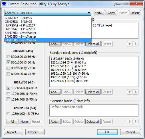

Sorry for this newbie question but I found (when running CRU on my 64bit Win 7) several entries:
- 2 of my current Monitor LG 34UM95
- 2 of my previous monitor HP w2207
- 3 of my very old monitor Samsung Syncmaster I tested a long time ago.
See attached snapshot
Why are there multiple entries for ONE monitor?
Can I delete the entries for the old monitors?
Will they be automatically re-created if I plugin them again?
Thank you
Peter
That's what's in the registry. Every connection has a separate entry in the registry, and sometimes different drivers will produce another entry. Connected monitors are supposed to show an "(active)" status, so something is wrong here. What video card do you have? How is the monitor connected to the video card? What driver did you install for your video card?
(03-11-2017 05:32 AM)pstein Wrote:  Can I delete the entries for the old monitors?
You can safely delete all the entries (which is what reset-all.exe does), but only active entries are recreated.
