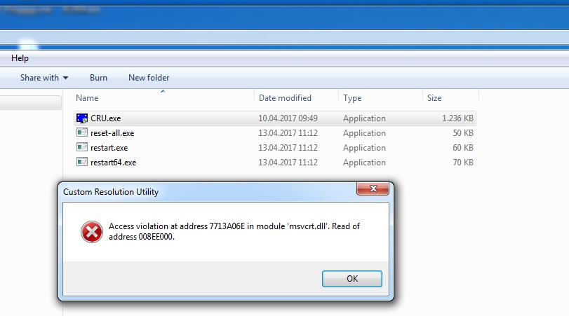

Post: #2747
Question RE: Custom Resolution Utility (CRU)
got a new monitor that will only run at 30hz at 4k resolution, not gaming but still too low.
was hoping to get a higher framerate using CRU but get an access violation when trying to open it. Anyone know to avoid the access violation?
I actually deleted the msvcrt.dll file as it was suggested to me but still same error...
i attached a picture of the error. thank you
04-13-2017, 12:35 PM
Post: #2748
(04-13-2017 11:07 AM)iyyama Wrote:  got a new monitor that will only run at 30hz at 4k resolution, not gaming but still too low.
noone knows what to do about it? mouse is too laggy for my work
