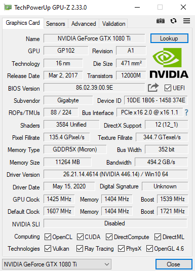

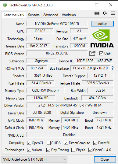

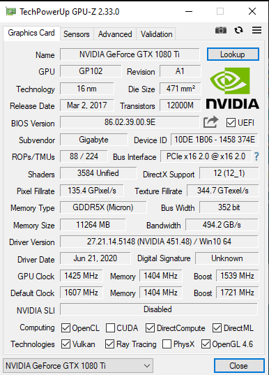

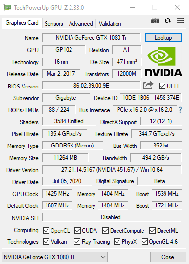

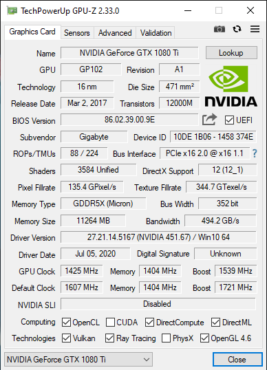

My two cents:
Patcher 1.4.11 changes the new TMDS limt an custom resolution are now working. 1.4.10 does not (for 451.67). But I have the same strange issue with CUDA/PhysX Driver 451.67 after pached with nvlddmkm-patcher-1.4.11: Driver 451.67 after restored the backup with nvlddmkm-patcher-1.4.11: Going back to 451.48 and patched 1.4.11 (!) -> CUDA/PhysX missing And for further testing - And this is strange! 451.67 "patched" with 1.4.10 (!) - TMDS missing - But here also CUDA/PhysX missing: 451.48 and patched with 1.4.10 everything is working. EDIT NOT CORRECT. Sorry. Also here CUDA/PhysX is missing! I guess I overlocked this in the past... Will try to find out when and with which driver this happens! |
07-12-2020, 01:07 PM
Post: #770
RE: NVIDIA Pixel Clock Patcher
OK - Tried driver 446.14 with patcher 1.4.11 and CUDA/PhysX are OK:
So it looks like its NOT the patcher but the driver starting 451.48+. Maybe NVIDIA itself changed something related to patching in generel and CUDA/PhysX. If this is only an cosmetic issue or the support is removed actually is out of my knowledge. Can't test this currently. But as @MedGR45 reported it removed the support... Maybe he can test if patched 446.14 works for him.... |
