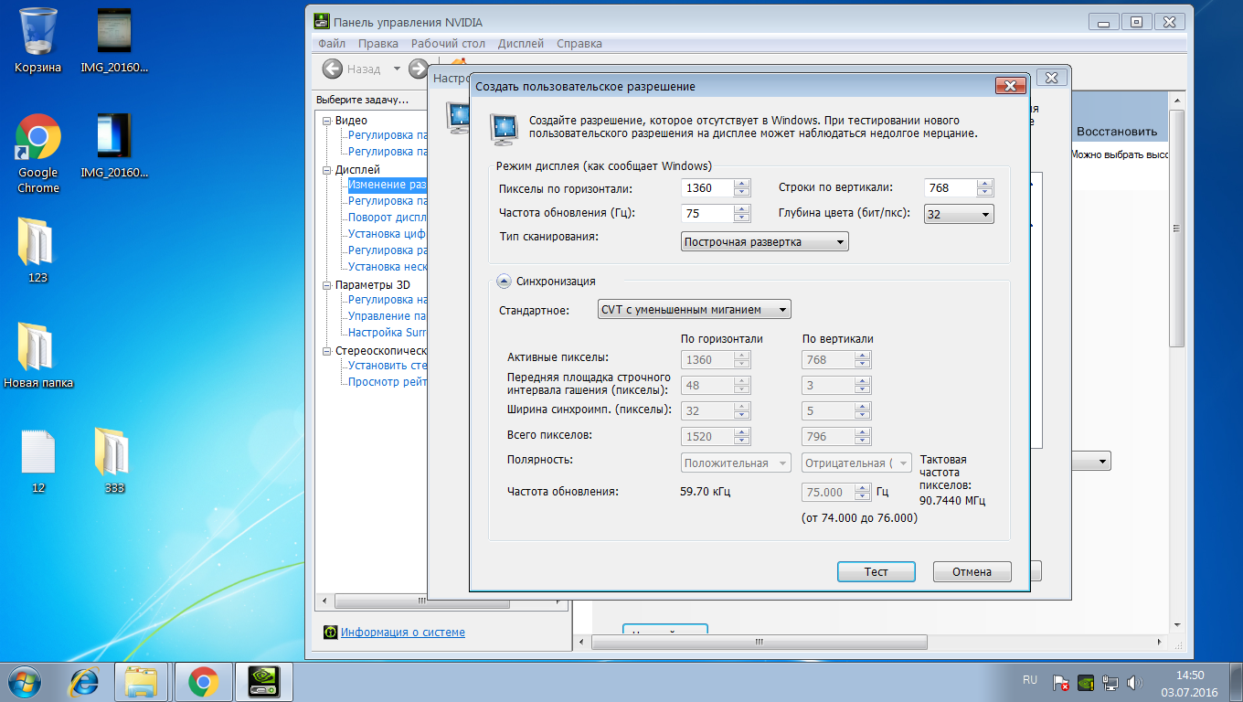

LG W1943SE (VGA)
GTX 750ti (tried 368.39 and then 362.00)
After patch i still have "bad" pixels with 75 hz. Nvidia panel - "auto" settings.
With CTV settings (screenshot) i have good pixels, but shifted to the left screen (photo). I cant move screen right using monitor or nvidia settings.
Please help

(07-03-2016 11:01 AM)Gonzales Wrote:  LG W1943SE (VGA)
Please help
The patch is for DVI and HDMI. It does nothing for VGA, and you don't need the patch anyway for pixel clocks less than 165 MHz. This is purely a monitor limitation. You'll have to figure out what timing parameters the monitor can handle at 75 Hz. Manually adjusting the horizontal front porch or total pixels might help.
VGA can have problems with positioning because the monitor has to figure out where the picture is when doing the analog to digital conversion, so the monitor might not be able to display 75 Hz correctly at all since it's only designed to support 60 Hz at the native resolution.
