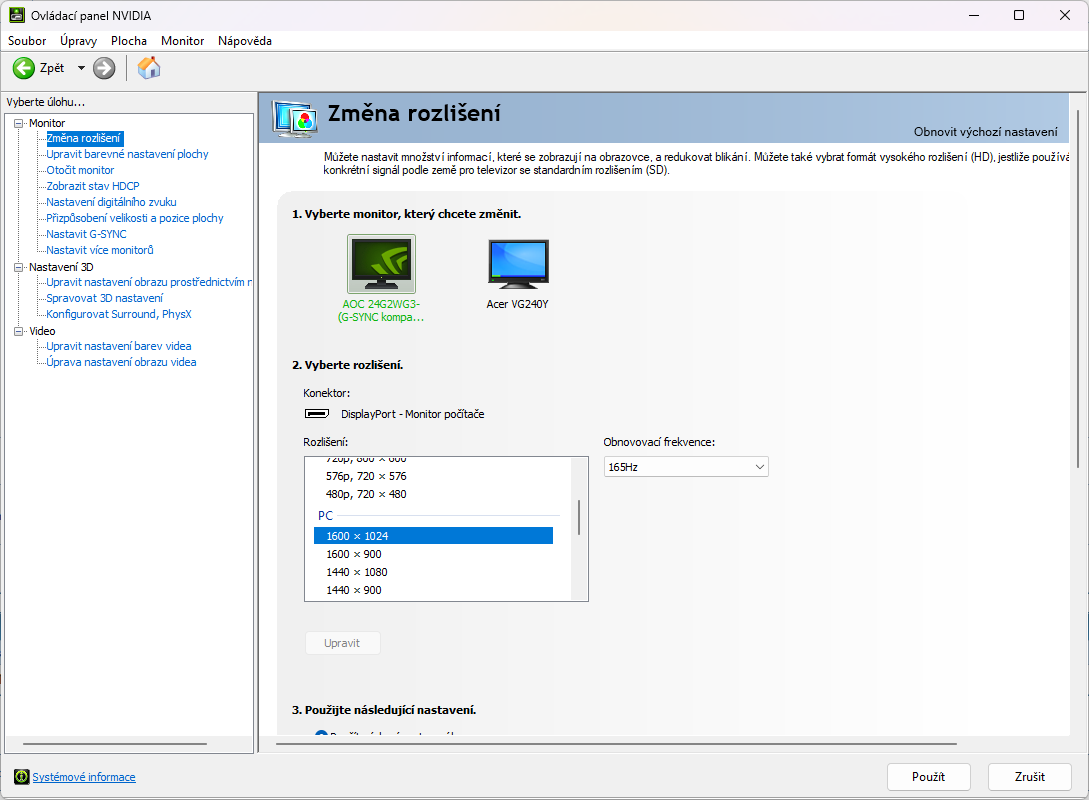

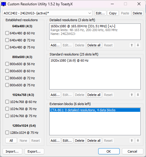

Hi! When I try to input my own resolution (1650 x 1080) it just doesn't show. Also when I tried to revert it all and restart, my second monitor did not receive any changes and has still the custom res (this doesn't really bother me but would like to know the issue)

You have TV resolutions in the extension block with 1920x1080 @ 60 Hz set to native, so maybe that's the issue.

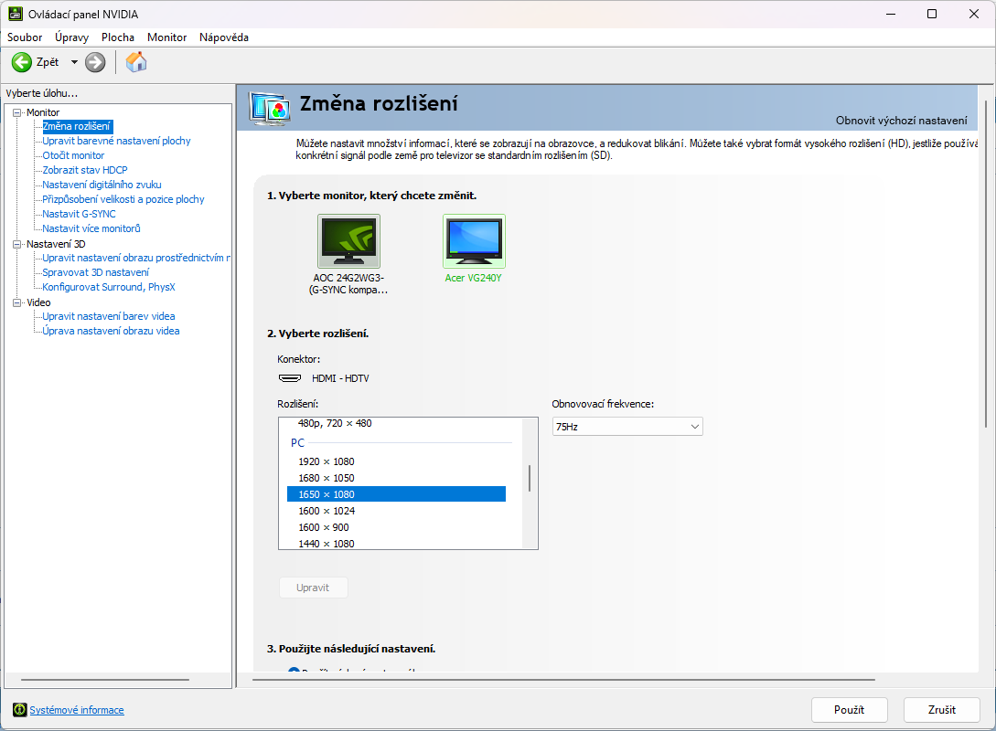

NVIDIA's driver also adds the resolutions from each monitor to the other monitors as scaled resolutions if they don't exist so they can be mirrored. The fact that 1650x1080 shows up on the other monitor means the driver recognizes the resolution was added, so if it doesn't show up on the edited monitor, then that's an NVIDIA driver bug.
Running reset-all.exe and rebooting should remove all changes. I don't see any changes on the other monitor, so there's no reason the resolution should still exist after removing it.

OK so I finally managed to fix it, the problem was that I had a custom resolution 1650 x 1080 and even tho I was not using it it was just not showing. By deleting the custom res it finally popped up where it was meant to pop up. Ty for help!
