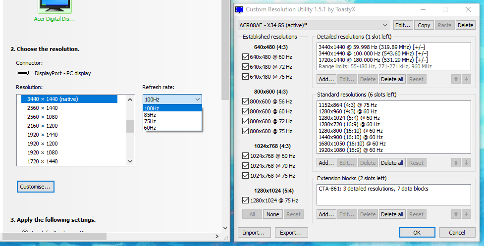

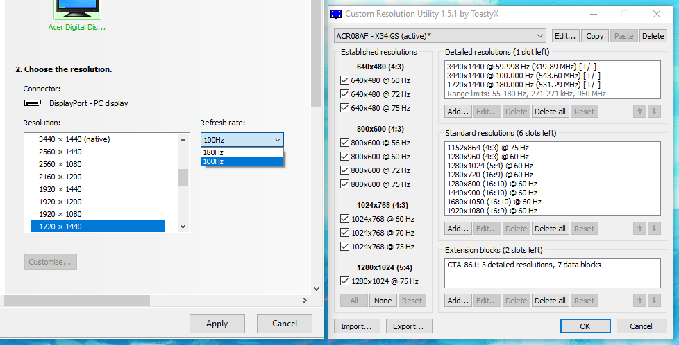

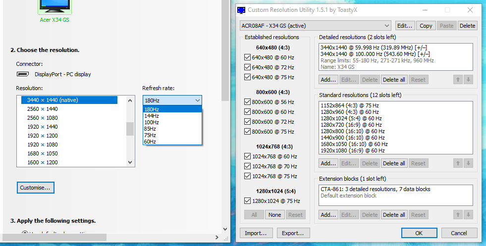

For reference, here are images showing refresh rates with and without the default extension block:
With:
Without:
And when adding a custom resolution added supporting 180Hz, here are images showing the range of refresh rates for standard and the custom resolution:
Standard res:
Custom res:
10-28-2021, 12:17 AM
RE: Setting a custom PBP resolution using CRU
You have to add 180 Hz back in manually because it's in the extension block that NVIDIA's driver couldn't read. There should be no issues with that.
