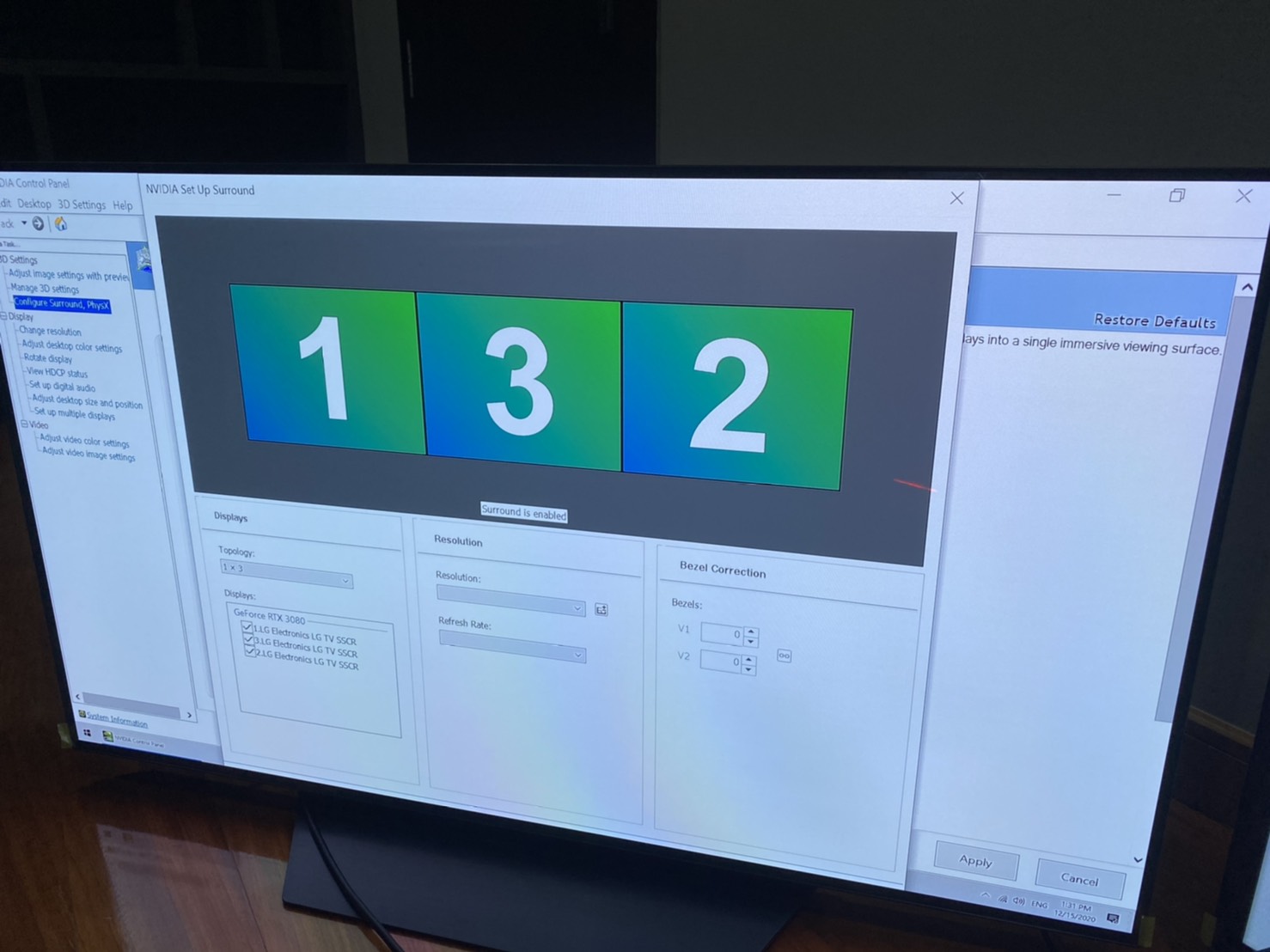

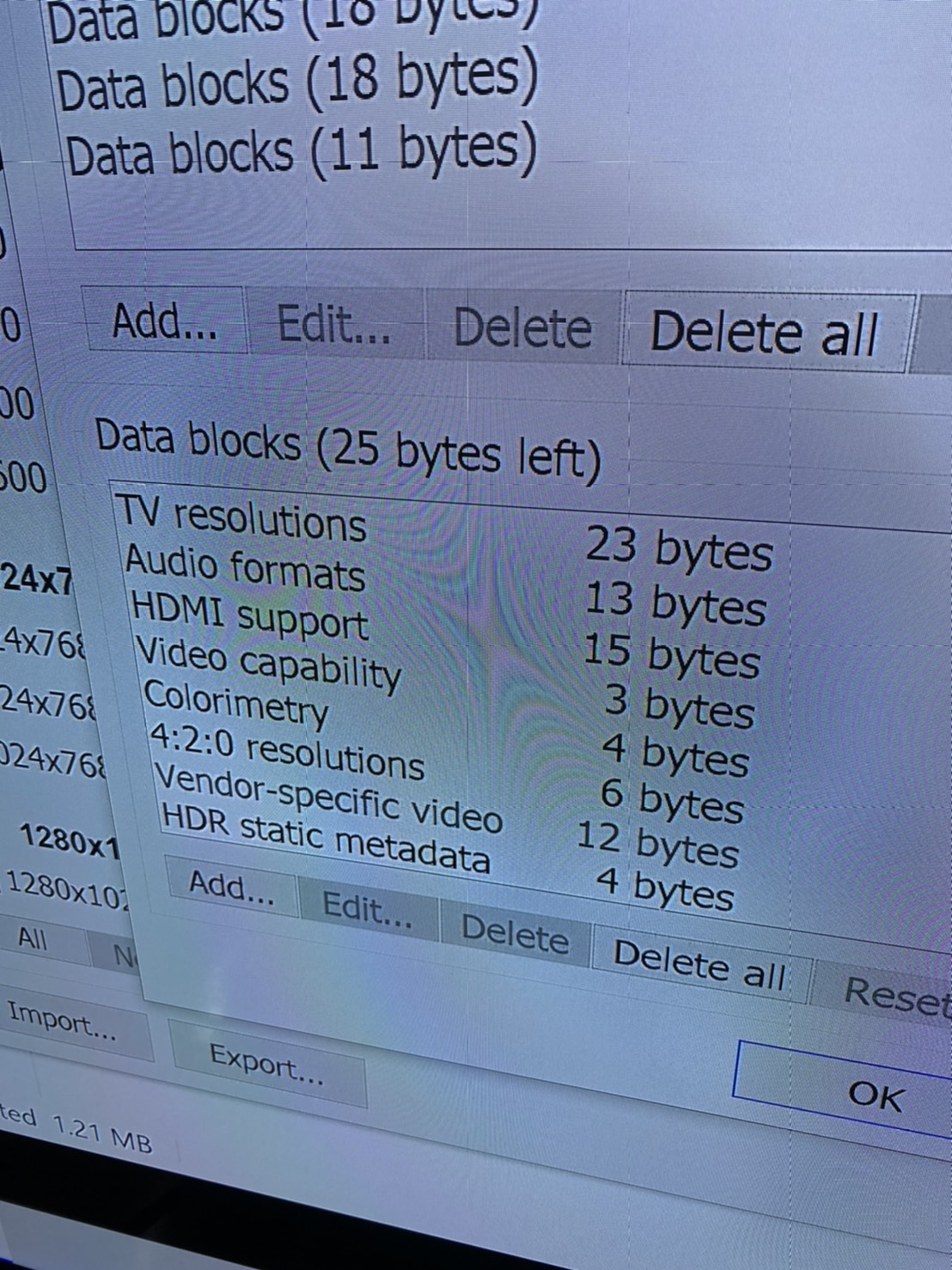

(12-14-2020 11:55 AM)ship1666 Wrote:  I just buy three LG CX48 for sim racing. I never use triple monitor before. After I run Nvidia Surround, it does not work. There is only one resolution I can choose which is 12288x2160. After I apply, only one work with weird resolution. However, two others have no signal. I find solutions on YouTube that how I know CRU. I try to solve the problem step by step
The problem is Surround chooses the highest resolution (3 x 4096x2160) for the main resolution, so you'll have to delete any resolutions that you don't want to use.
1. Disable all the established resolutions
2. Delete all the standard resolutions
3. Delete the TV resolutions data block in the extension block
4. Delete the HDMI resolutions in the HDMI data block (do not delete the HDMI data block)
5. Delete any 4:2:0 resolutions and capability map data blocks if they exist
6. Delete all the detailed resolutions in the extension block and the main page
Then create one detailed resolution on the main page using "LCD standard" for the resolution you want to use for each monitor, such as 2560x1440, which will give you 7680x1440. Then use the copy and paste buttons at the top of the main page to copy the configuration to all the other monitors. Then reboot and set up Surround.

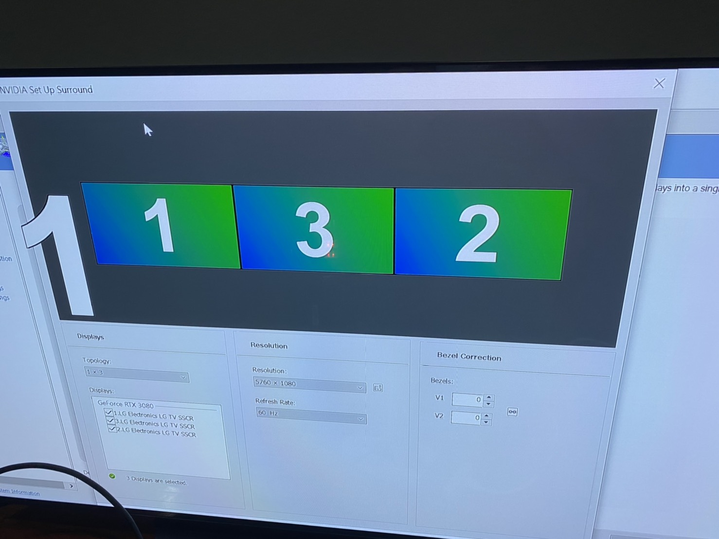

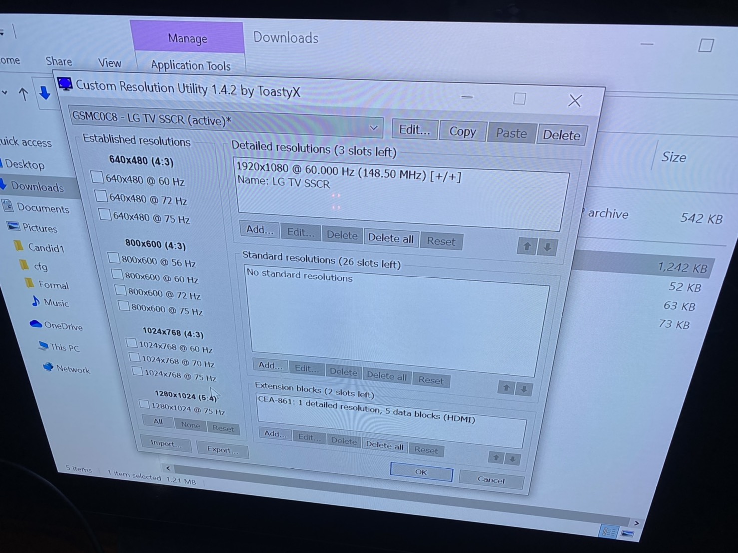

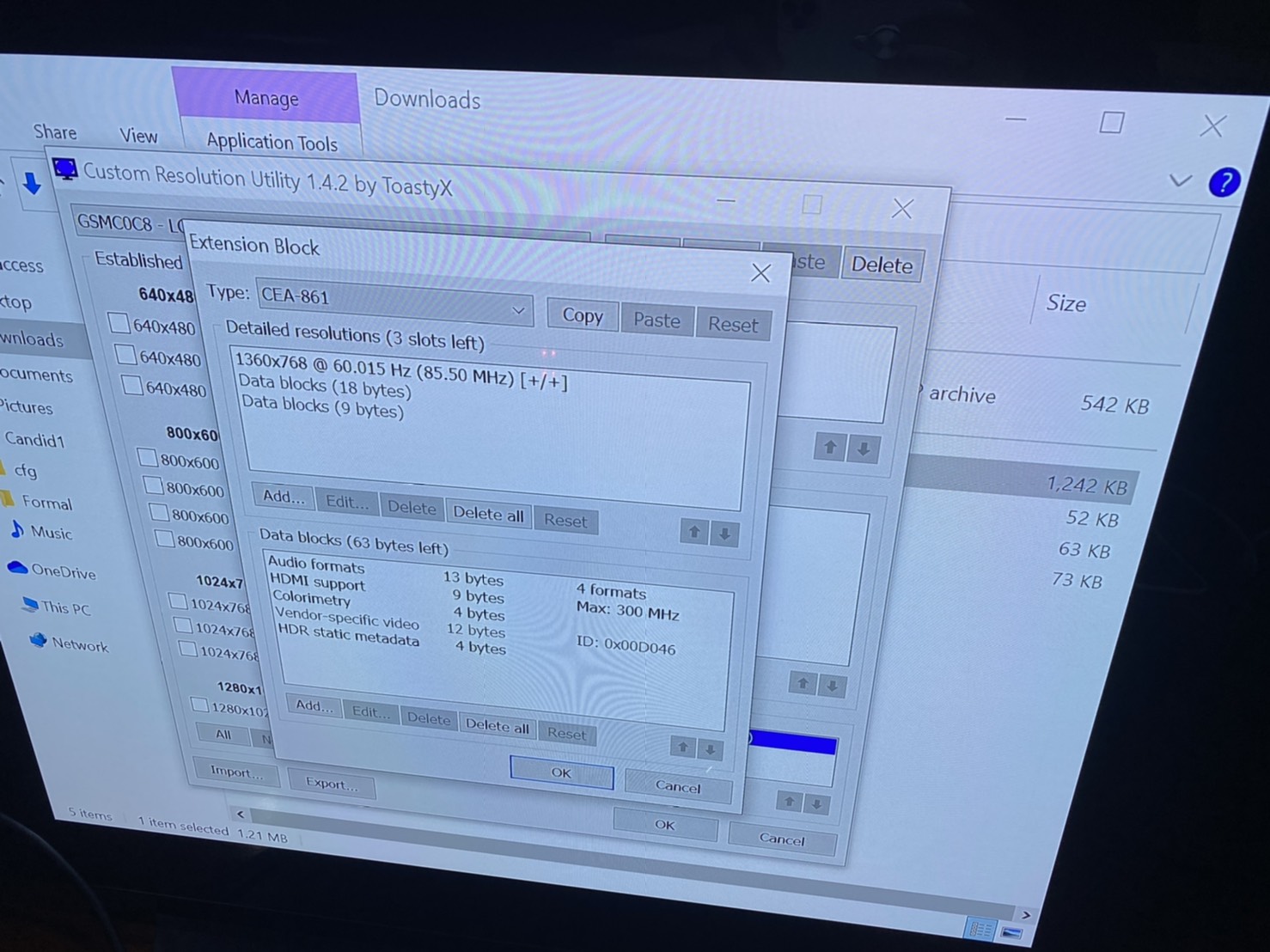

Hi ToastyX
Thank a lot for your help I almost make it.
I follow your steps and what happen is I get the collect resolution to choose in NV surround after boot up. However, after I click apply, only one TV has signal and others two still has no signal. When I open NV surround, The resolution changes back to 2560x1440. In additional, for 1920x1080, the resolution shows blank space. Therefore, please see the attached pictures to check what I miss, thank a lot ToastyX.
PS. 5. Delete any 4:2:0 resolutions and capability map data blocks if they exist
- It means I have to delete the whole Video Capability and 4:2:0 Resolutions in Data Blocks right?
Thank you a lot for your kindness

(12-15-2020 06:59 AM)ship1666 Wrote:  I follow your steps and what happen is I get the collect resolution to choose in NV surround after boot up. However, after I click apply, only one TV has signal and others two still has no signal.
Something is wrong then. What kind of adapters are you using? You might need active adapters for Surround to work with three monitors.
(12-15-2020 06:59 AM)ship1666 Wrote:  PS. 5. Delete any 4:2:0 resolutions and capability map data blocks if they exist
You don't need to delete the video capability data block. Only 4:2:0 resolutions and 4:2:0 capability map if it exists.
