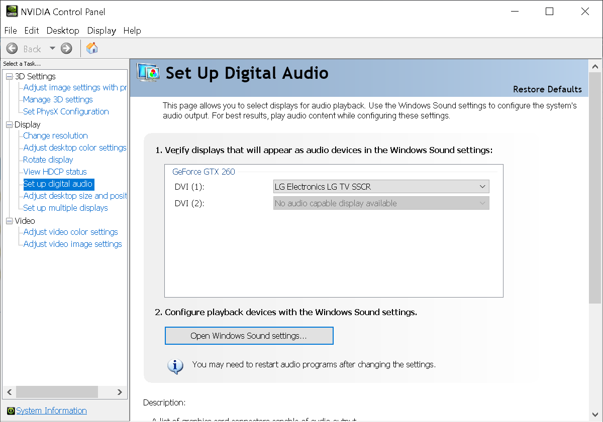

If I go to the NVidea Control Panel, it looks like the driver is seeing the LG TV...
But when I open Windows Sound Settings I only see the spdif optical and headphone outputs available...
I'm stuck at this point and don't know whether there's a conflict between my CRU definitions and NVidea Control Panel. Any advice would be appreciated...8-)

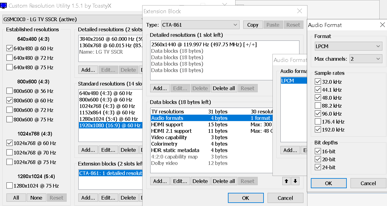

CRU shows 1920x1080 (16:9) @ 60 Hz by default in the Standard Resolutions section. I did a reset-all and then a restart64 and the video is still working. So I must have initially recreated what was already present (I'm new to CRU). But with the CRU default values applied I still don't have any audio, and I can't see the TV in the windows sound settings. FYI I have the HDMI Input Audio Format on the OLED set to PCM (not Bitstream). Here is a screenshot of what I see in CRU regarding the audio...

You need an HDMI data block for audio to work, but you shouldn't have to add any of these data blocks because the TV already defines them by default. Adding a standard resolution isn't the correct solution either, and you shouldn't have to add 1080p because the TV already defines that by default. What did CRU show by default?
Do you think there's any way to get the audio working with my current setup, or do I need to start looking for an HDMI graphics card? I didn't really have that in the budget for right now! Thanks in advance for any advice...8-)

(05-19-2021 04:27 PM)stevied53 Wrote:  Do you think there's any way to get the audio working with my current setup, or do I need to start looking for an HDMI graphics card? I didn't really have that in the budget for right now! Thanks in advance for any advice...8-)
Your card doesn't seem to support HDMI audio through the DVI port, so you would need to get another card with HDMI, or you can output audio separately using the line out on your sound card or motherboard.
