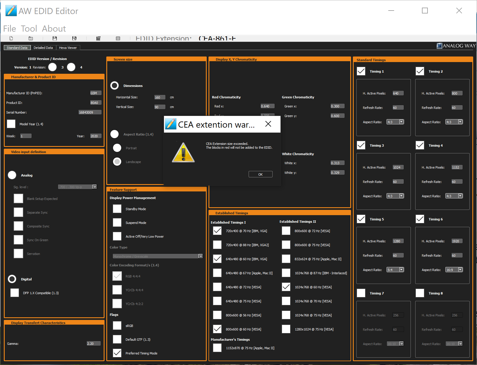

02-11-2022, 07:30 AM
Post: #6397
(02-09-2022 04:16 PM)ToastyX Wrote:
(02-09-2022 01:41 AM)JayBee Wrote:  Still convinced it has something to do with the big amount of data in the EDID report, as all devices with EDID copy function I tested with it also had issues (usually breaking several features).
Where are you seeing a big amount of data? The EDID dump looks perfectly fine, and CRU reads everything just fine. I also checked with edid-decode, and it didn't report any issues. The crash is definitely an NVIDIA driver bug as other people with NVIDIA GPUs have reported the issue with some displays.
What changes are you making? The only potential issue I see is the 4:2:0 capability map defines the first 8 TV resolutions as 4:2:0 resolutions, but if you have at least 8 TV resolutions, then the data is still valid, although maybe not what you want. You can delete the capability map if you're not using 4:2:0.
Here, the error the AW EDID Editor is giving me.
I also got the same type of error on another EDID app (I don't remember the name). I do understand those app are old and probably don't support it tho.
I get that you say it's an issue with the drivers, but then that doesn't explain why did it work only once for me on my old windows, and never again (with the same old drivers from the exact same installer, with a clean install). Also as I stated before, once I got it working, it did continue working even when I updated the drivers. Tbh I did so many tests back then that I have no idea what I could have done that would have made it work.
I tend to believe it's more an issue with something special getting messed up in the drivers when changing anything, as my TV already caused crashes on my PC before without any drivers modifications. Maybe the Gsync, or HDR? No idea.
And as for what I modify, right now I am trying to remove the 4096x2160 res from the EDID. But as I said, modifying ANYTHING in it results in a crash. Heck even modifying something, modifying it back and then restarting the display drivers is still making it crash.
It seems to me that any modification to it corrupts it for some reasons.
I also tried modifying only the sound settings, changing the default res, removing hdr, changing color settings... nothing helps.

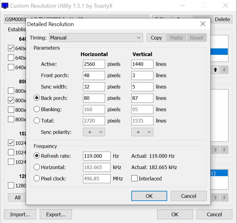

The problem i'm having at the moment with cru and 2k is that my image is very blurry when using a custom resolution and refresh rate through cru, the default 2k ones don't have this problem. This are the settings that i'm using :
02-11-2022, 07:07 PM
Post: #6399
(02-11-2022 08:12 AM)SPEED Wrote:  The problem i'm having at the moment with cru and 2k is that my image is very blurry when using a custom resolution and refresh rate through cru, the default 2k ones don't have this problem. This are the settings that i'm using :
Differences in scaling quality are usually one of these:
1. GPU scaling vs. display scaling
2. RGB/YCbCr 4:4:4 vs. YCbCr 4:2:2/4:2:0
3. TV scaling differently at 8 bpc vs. 10/12 bpc
4. TV scaling differently at specific refresh rates or with certain timing parameters. The standard refresh rates for TVs are 24/25/30/50/60/100/120 Hz.
Post: #6400
(02-11-2022 07:30 AM)JayBee Wrote:  Here, the error the AW EDID Editor is giving me.
AW EDID Editor is choking on the HDR static metadata block and then calculating the total size incorrectly, adding two detailed resolutions that aren't there. Deltacast and EEditGold read it without complaints. There is nothing wrong with the EDID, so I don't know what is triggering the crash. Crashes can only be driver bugs or hardware issues.
