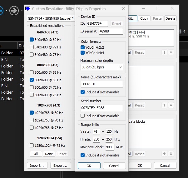

(03-07-2024 05:24 PM)ToastyX Wrote:(03-07-2024 04:16 PM)LaPsiuta Wrote: how? i don't know how to do thisJust delete the refresh rates you don't want. i edited vrate to 120 and i still have 144 in games and win cp. |

(03-08-2024 02:40 PM)ToastyX Wrote:(03-08-2024 09:06 AM)LaPsiuta Wrote: i edited vrate to 120 and i still have 144 in games and win cp.I didn't say edit the vrate. Ok so what shoud i do step by step? I don't have avaliable resolutions list. |
