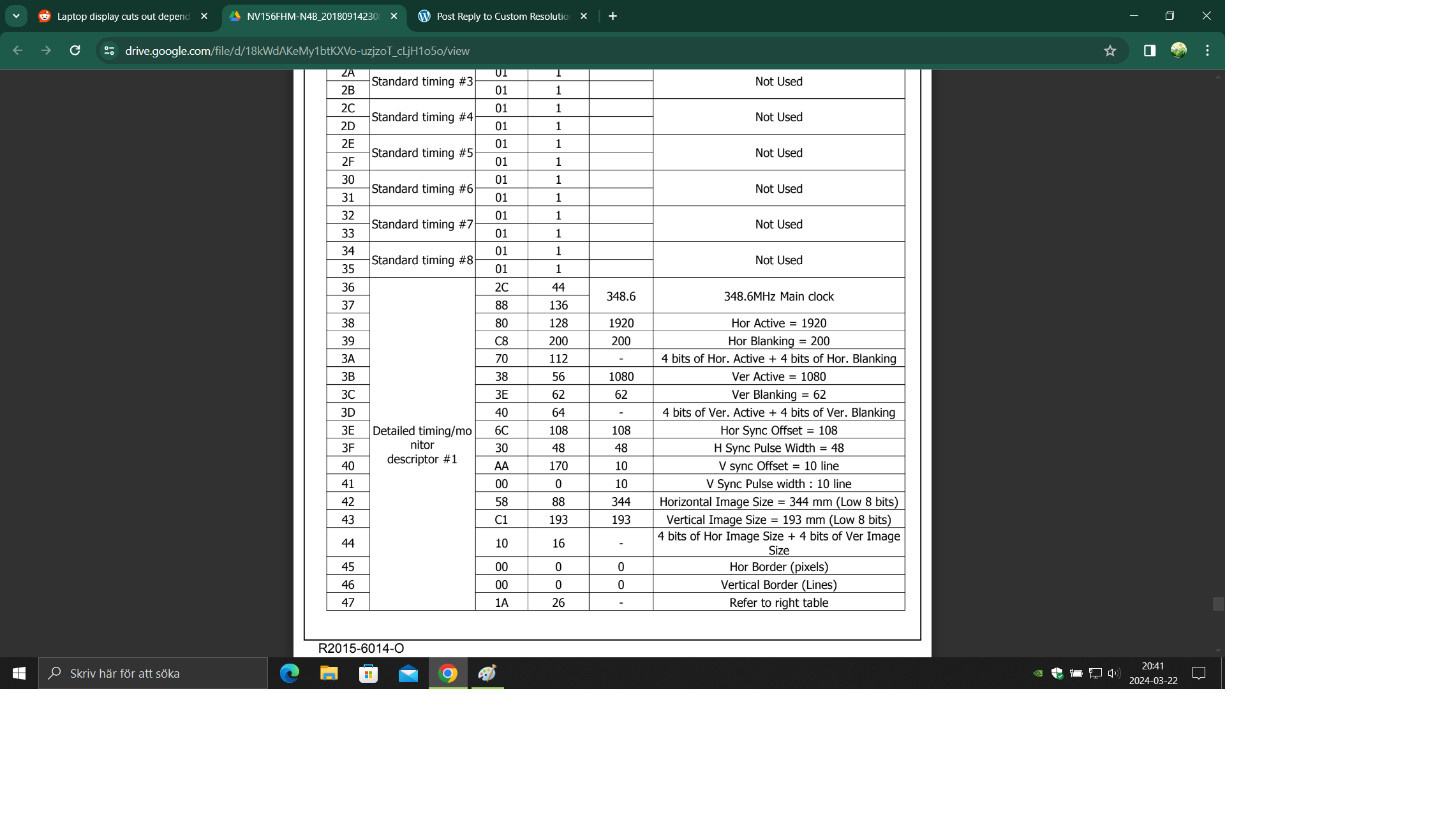

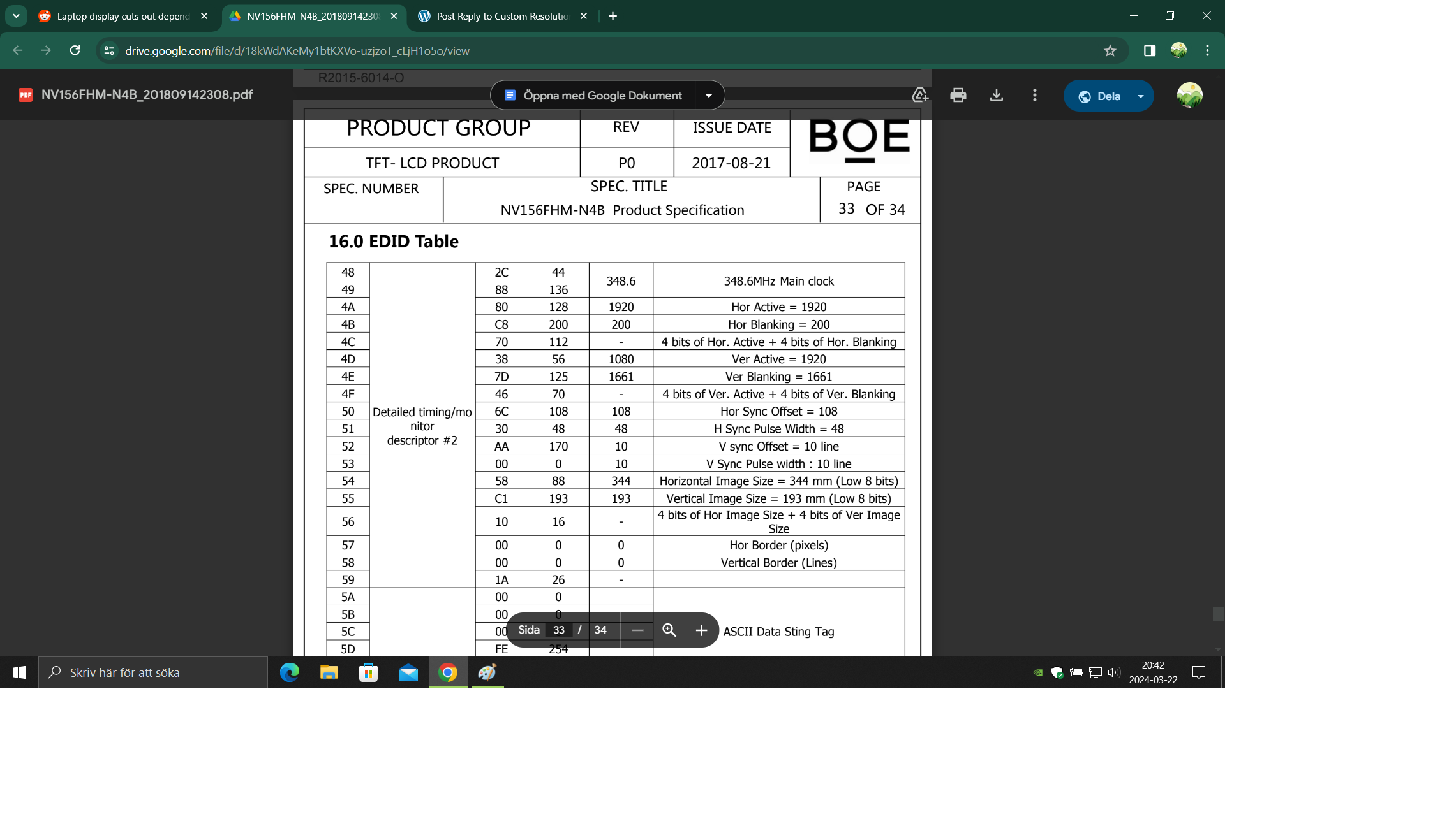

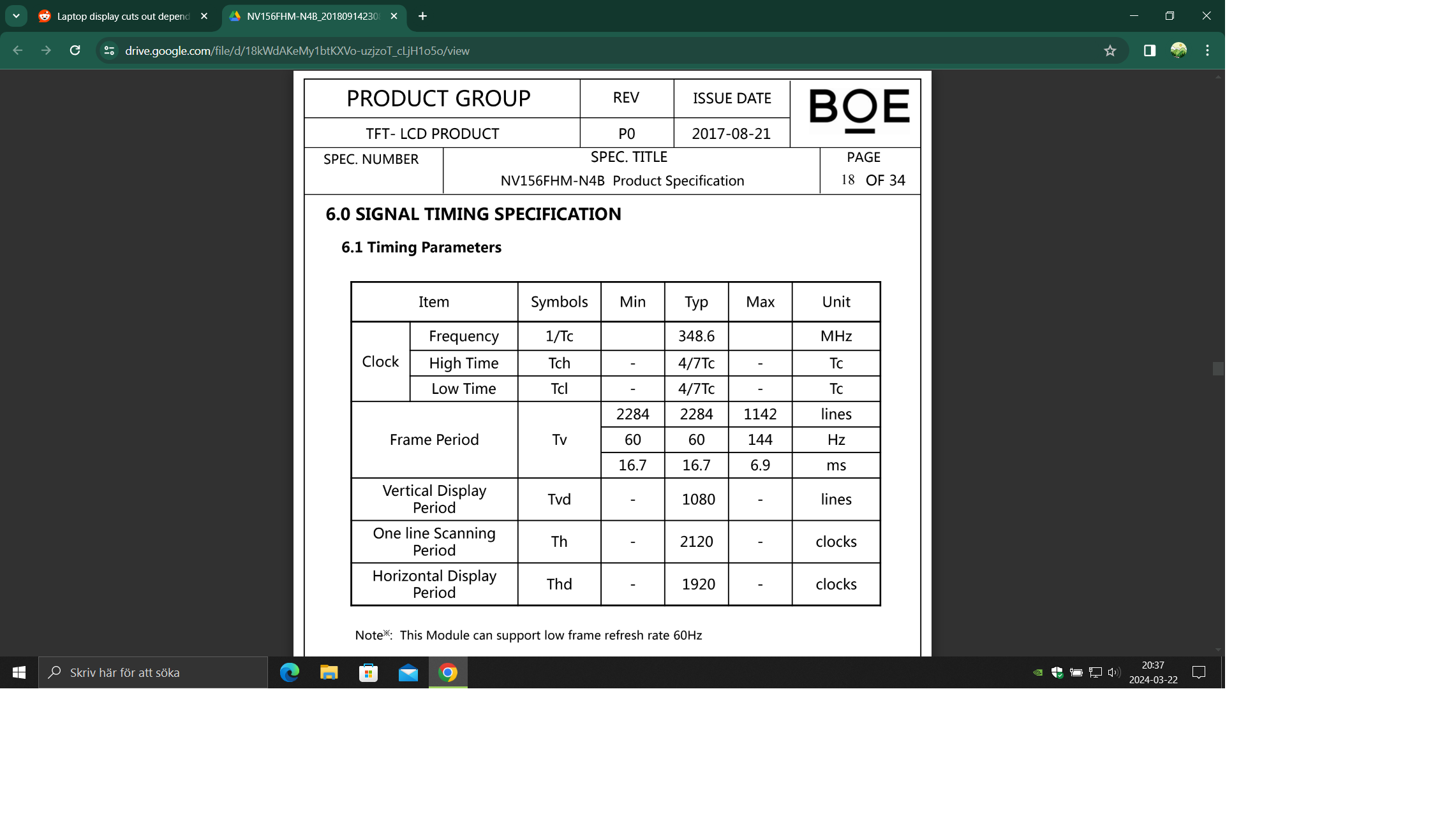

(03-21-2024 04:59 PM)JUZY Wrote:  I have an OMEN by HP 15-ax208no Laptop. I have recently replaced the original screen with a BOE NV156FHM-N4B 1920x1080 144hz.
The screen works as it should but when I installed it, only the 60hz (original screen hz) option came up.
I have tried different options via CRU but I can only get the screen to come up to 72hz. If I set it to 144hz, the screen splits in two and stutters. If I set it to 75hz, the color is washed out, almost making it black and white.
Anything above 75hz results in the screen splitting in two and stuttering.
I wonder if there is any way to solve this or if it is the screen that is wrong or the laptop?
Seems like either it's the wrong panel, or it only supports 144 Hz with specific timing parameters, which would be in the data sheet.
Which of these are timing parameters? If it is the right data, which columns do I fill in the CRU?
03-23-2024, 12:16 AM (Last edited: 03-23-2024, 12:16 AM by ToastyX)
Post: #8063

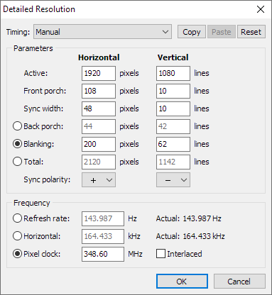

(03-22-2024 07:46 PM)JUZY Wrote:  Which of these are timing parameters? If it is the right data, which columns do I fill in the CRU?
The second one. Should look like this:
