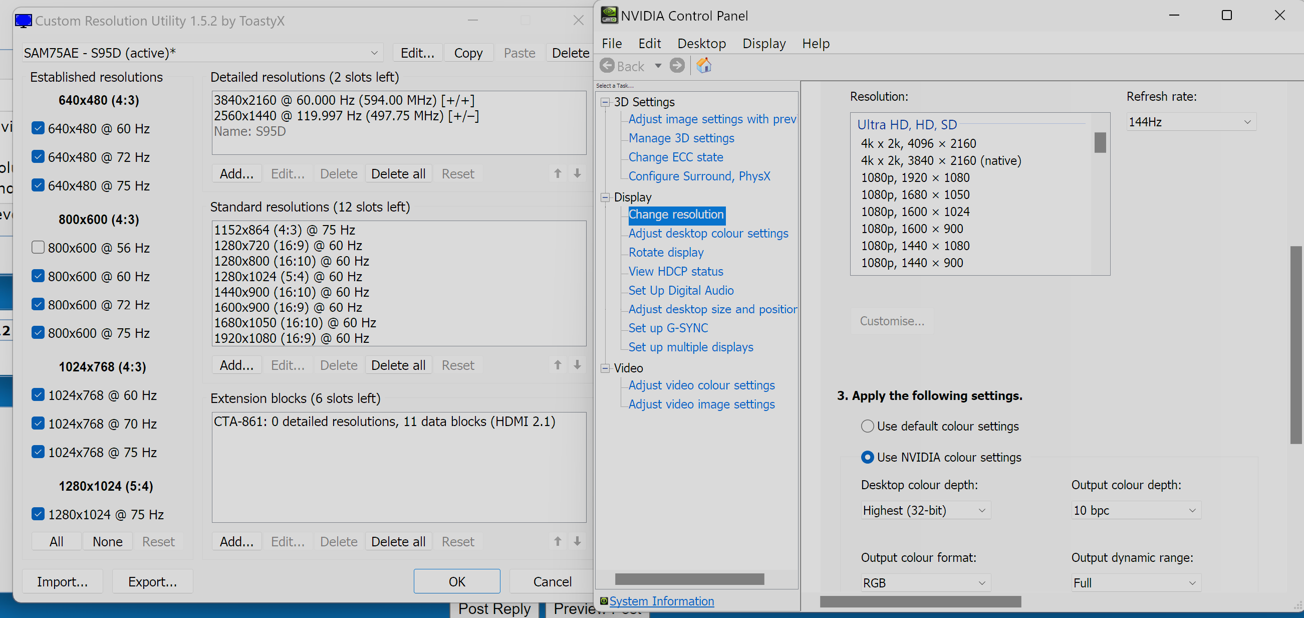

(04-21-2024 05:22 PM)ToastyX Wrote:  Is there another extension block? I need to see everything. Run this and post the test.txt here: https://www.monitortests.com/EDID-test.zip
Appreciate the response Smile No, only the one extension block. Screen grab below (along with an image of NVCP for info).
Have also attached test.txt. Thanks...
.txt  test.txt (Size: 15.53 KB / Downloads: 524)

(04-21-2024 09:28 PM)Scoobyroo Wrote:  Appreciate the response Smile No, only the one extension block. Screen grab below (along with an image of NVCP for info).
Does it work if you delete the "Extension override" data block in the extension block?

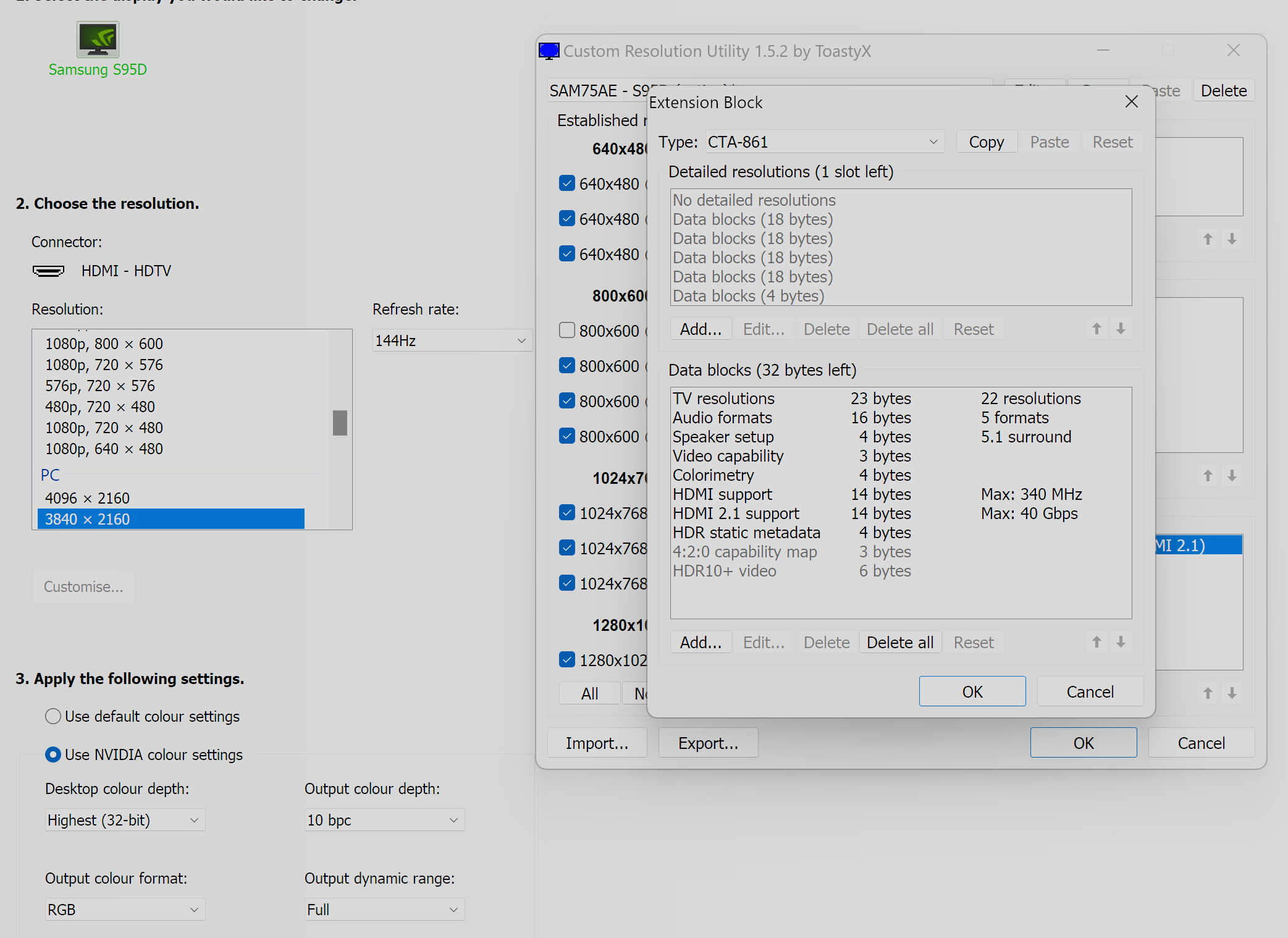

04-21-2024, 10:12 PM (Last edited: 04-21-2024, 10:21 PM by Scoobyroo)
Post: #8127
(04-21-2024 09:41 PM)ToastyX Wrote:  Does it work if you delete the "Extension override" data block in the extension block?
Afraid not Sad

(04-21-2024 10:12 PM)Scoobyroo Wrote:  Afraid not Sad
This would be an NVIDIA driver bug then. Last I heard NVIDIA's driver ignores EDID overrides with certain displays such as the S95C, so this might also affect the S95D. Previously CRU wasn't able to read the extension blocks at all for displays affected by this issue, but you're able to read the first extension block, so I don't know if NVIDIA fixed that part or if the S95D is different. Technically the display has two more extension blocks that CRU doesn't list, but with the "Extension override" data block deleted, the EDID override is complete as you have it, so it's supposed to work. That needs to be reported to NVIDIA.
