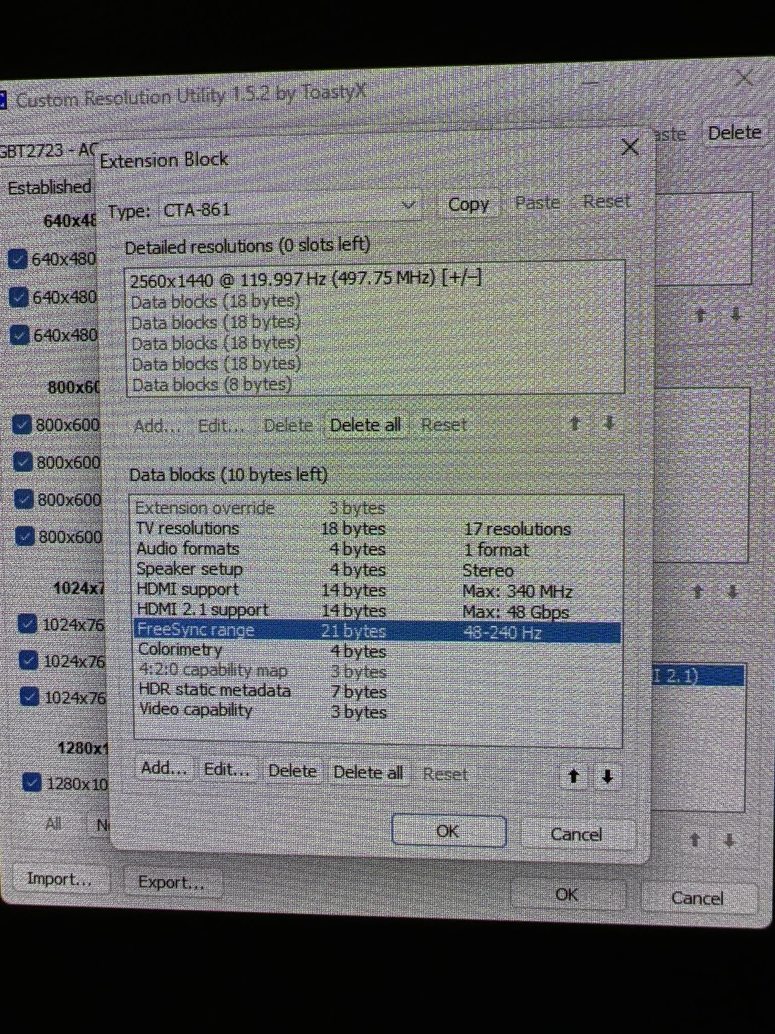

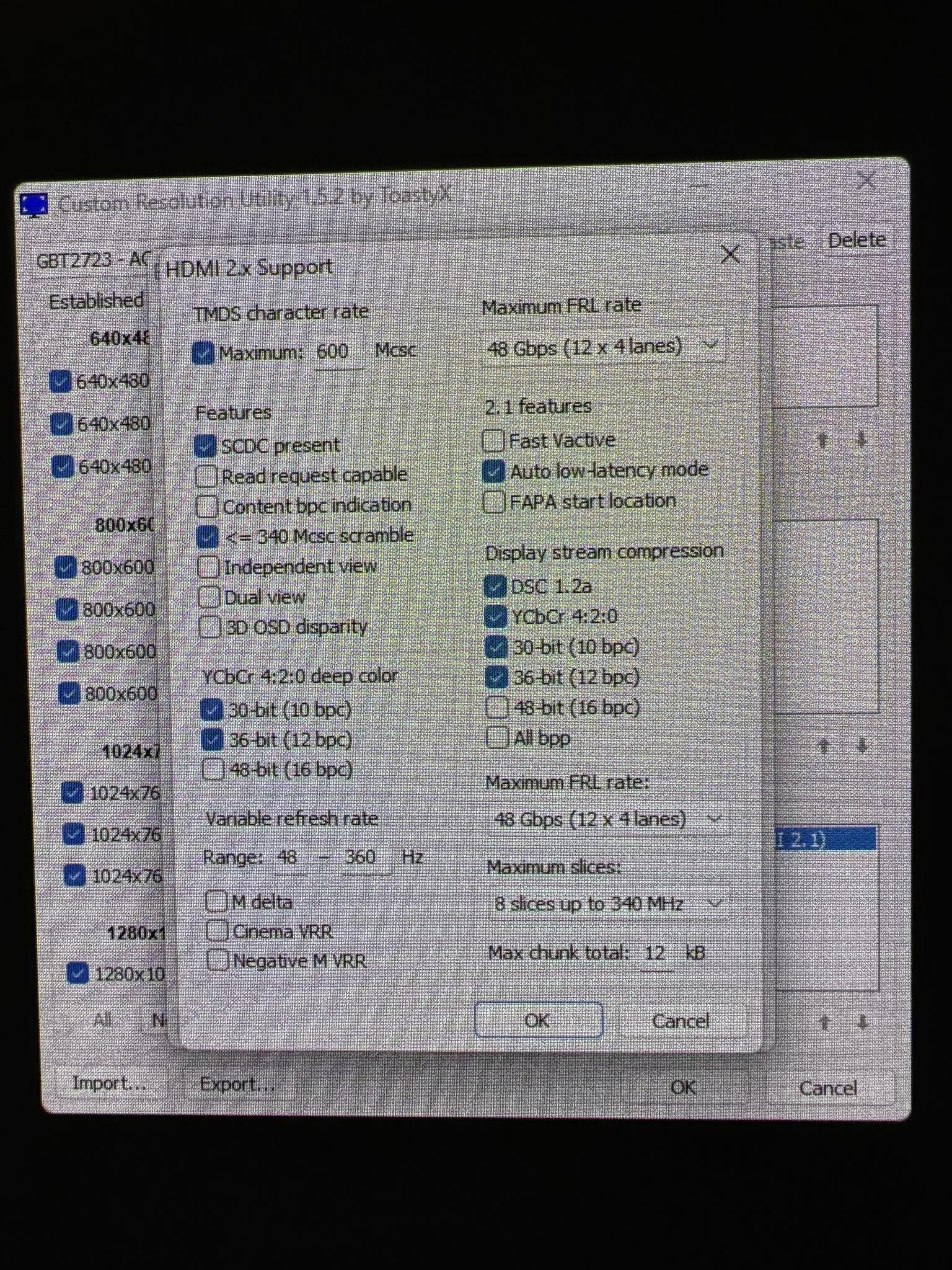

Post: #8183
i bought a new 360Hz oled monitor Gigabyte FO27Q3.
When I checked CRU to remove 4K resolutions on HDMI connection I noticed the following:
Variable refresh rate under HDMI2.1 support shows 48-360Hz range. But
FreeSync range shows 48-240Hz only
Any idea why it only shows 240Hz for FreeSync? It should be also 360Hz, or am I wrong?
Thank you in advance

Post: #8185
(05-08-2024 07:14 PM)csobikaaa Wrote:  Any idea why it only shows 240Hz for FreeSync? It should be also 360Hz, or am I wrong?
The FreeSync data block can only define a maximum of 255 Hz. The data block is proprietary, so I don't know if there is a new way to define higher ranges. It might just be there for backward compatibility with older GPUs that don't support HDMI 2.1.
Thank you!
