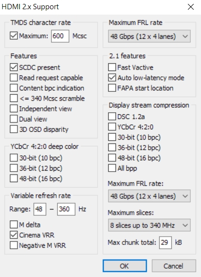

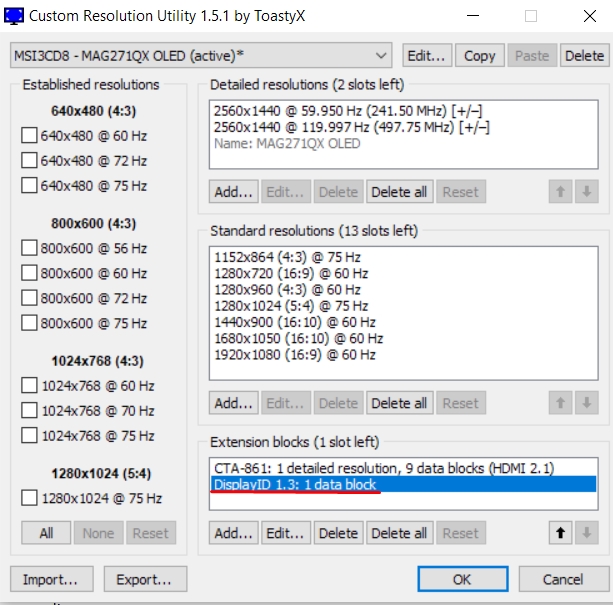

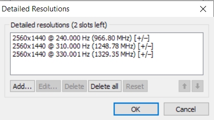

Hello.
I have msi 271QPX - it is a 2560x1440@360hz 10bit monitor. I am using HDMI 2.1.
I decided to try out disabled DSC. If I disable DSC in OSD menu - I have 240hz max.
But looks like hdmi 2.1 without DSC should be okay up to 2560x1440@319hz 10bit.
So I am trying to use CRU to archive more Hz without using DSC.
Not sure that im doing everything right, so correct me if you want.
In CRU I added DisplayID 1.3 and added resolutions: 2560x1440@320Hz, 2560x1440@330Hz 10bit.
With disabled DSC 2560x1440@330Hz - should not work. But it works! Why?
To confirm it, I disabled DSC in HDMI 2.1 support(not sure if it could help)
Retested: 2560x1440@330Hz 10bit - working.
I tried also 2560x1440@335Hz 10bit - it is not working.
Also I measured alt+tab speed to understand if DSC is active or not.(I dont know any other method to test DSC active or not)
DSC ON 2560x1440@360Hz 10bit - ~4.7sec (5tests)
DSC OFF 2560x1440@330Hz 10bit - ~3.6sec (5tests)
So looks like DSC is really off with HDMI 2.1 2560x1440@330Hz 10bit? But how is it possible? Where I could be wrong?
Thanks!

Why should it not work? 48 Gbps has an effective data rate of around 42.6 Gbps, which is enough for around 1420 MHz pixel clock at 10 bpc. I don't know the exact limit since I can't test it, but NVIDIA GPUs are limited to around 1350 MHz anyway, which is still enough for 330 Hz.
