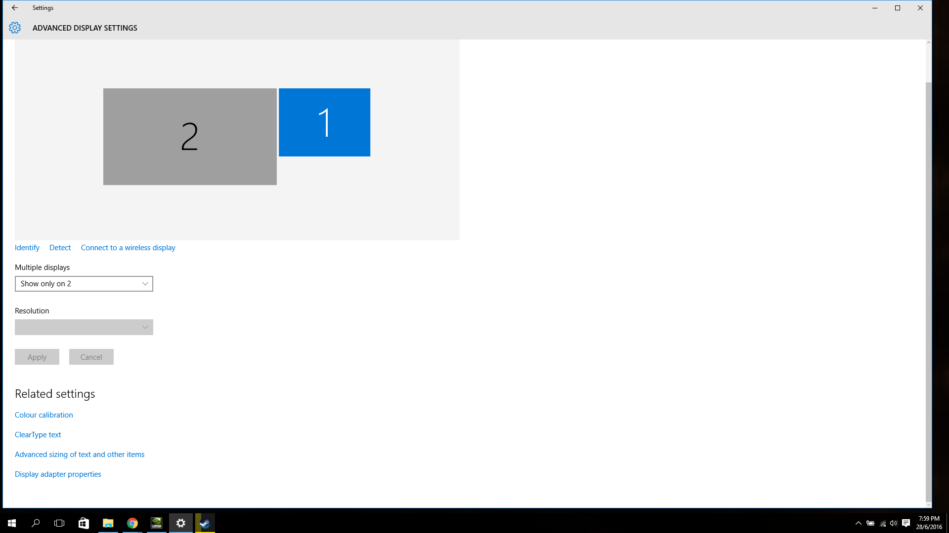

Hi toasty,
First up, thank you for making the tool! I've ran into some problems while trying to fiddle with the settings to get a higher frame rate. I'm by no means a computer expert so I might use some terms wrongly while explaining my problems but here goes.
I am using an external display connected to my laptop through a HDMI port. I make the extended display my only display, and im running on a 970M.
I've been trying to add custom 'detailed resolutions' using the default 1920x1080 provided settings, then switching to manual and then keying in the desired refresh rate (i tried 144 then 120hz). After adding, I switch to custom extension block as suggested by some other websites for nvidia users, hit okay and then restart 64bit. Then, I open up display settings for windows 10>advanced display settings>display adaptor properties>monitors>then change my refresh rate there to the one i specified.
After trying a few times and not working, I've decided to roll everything back to before i started and so i hit reset.exe. But after resetting I could not open display adaptor properties anymore. Also, I cant change my screen resolution (greyed out). I then tried deleting the display (top right) resetting and rebooting my computer. still unable to open and resolution greyed out.
I then rolled back my nvidia drivier and then updated it again, still the same result. Only when I extend the display or use the laptop display I can change these settings again, not even when I use the CRU utility to add a custom resolution and hit 'ok'. Is there anything I can do to roll back the changes by CRU?
I'm sorry if this is a really basic question, thank you for your time.

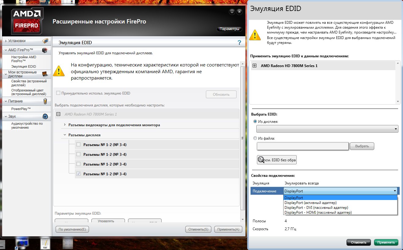

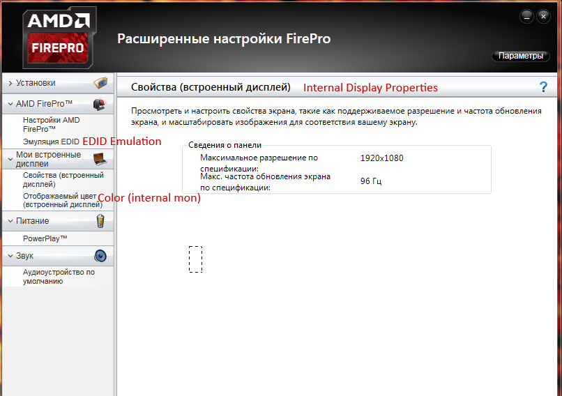

06-27-2016, 01:41 PM (Last edited: 06-27-2016, 01:41 PM by James D)
Post: #2136
It takes serious amount of skill and knowledge to fix my 2 days of frustration!
And now thanks to you:
A) I have no more Brightness bug, stable 96Hz, just flashing new EDID made by CRU with only memory clocks not dropping down at 96Hz (not a big deal).
B) I can switch resolutions (1080@72>>1080@96) in a blink of an eye with Ctrl+Shift+7 and Ctrl+Shift+9 with HRC in autostart with Windows!
It's a relief I was looking for, my deep Thank You!
P.S. About different GPU having limitations with internal display I think it's the case. For example on Nvidia Fermi GPU 96Hz and 100Hz from the EDID mod I had worked but gave greenish colors instead of yellow while AMD gave good colors on 96 but 100Hz didn't work at all.
P.P.S.
(06-27-2016 04:32 AM)ToastyX Wrote:  Radeon Settings has custom resolutions under Display -> Additional Settings, and then under My Digital Flat-Panels -> Custom Resolutions. FirePro cards have always had custom resolutions available. AMD only recently added custom resolutions for all cards with Crimson.
My display is connected through LVDS, maybe that is why AMD doesn't show those settings. Nvidia did but AMD doesn't, not on my laptop at least.
There is also EDID Emulation Tab in Settings but it allows to change only VGA and 3 Display ports (you can look at the attachement). Anyway, I am HAPPY now. Thank you again Smile

(06-27-2016 06:42 AM)cskhola Wrote:  After trying a few times and not working, I've decided to roll everything back to before i started and so i hit reset.exe. But after resetting I could not open display adaptor properties anymore. Also, I cant change my screen resolution (greyed out). I then tried deleting the display (top right) resetting and rebooting my computer. still unable to open and resolution greyed out.
That's perplexing because running reset-all.exe and rebooting should reset everything, and I haven't heard of this happening before. Are you able to set the resolution in the NVIDIA control panel? If not, try reinstalling the NVIDIA driver after using DDU: http://www.wagnardmobile.com/?q=display-...aller-ddu-

Hey Toasty,
Thanks for your reply. I'm able to set the resolutions from the NVIDIA control panel. This is a screen shot of my options:
I'm currently only running on my external display, when i unplug it i am able to access display adaptor properties again, however it seems to be different from when I was able to access it here (Its now the IntelHD card instead of the NVIDIA card).
I tried using that tool you suggested and reinstalling the driver but I am still unable to access it. Also I would like to add that under Nvidia control panel>display>change resolution, I lost the ultraHD,hd,sd resolution options right after I used the reset all file. But, after reinstallation its there again.
Once again, thank you for your time!

(06-28-2016 10:36 AM)cskhola Wrote:  Thanks for your reply. I'm able to set the resolutions from the NVIDIA control panel. This is a screen shot of my options:
Your screen shot shows you have display 1 selected. You need to click on display 2 to set the resolution.

06-28-2016, 01:12 PM (Last edited: 06-28-2016, 01:14 PM by cskhola)
Post: #2140
(06-28-2016 10:36 AM)cskhola Wrote:  Also I would like to add that under Nvidia control panel>display>change resolution, I lost the ultraHD,hd,sd resolution options right after I used the reset all file. But, after reinstallation its there again.
I don't see how that could happen. It should be the opposite. Using CRU can remove those options, but running reset-all.exe would bring them back.
Also, you mention having a laptop with Intel+NVIDIA GPUs. CRU shouldn't have any effect on laptops with switchable graphics unless Intel changed something recently. The Intel GPU handles the resolutions, and Intel's driver doesn't support EDID overrides. You have to use Intel's control panel to add custom resolutions.
Um Toasty I'll go bury myself in the sand right now, I clicked around displays 1 and 2 previously but I didnt take a look at the resolution options i think. I'll just back away slowly until other posts cover my embarrassing mistake up.
I dont know enough to accurately describe or guess at what happened for the bottom bit. It is likely that I've described something wrongly.
I'll try fiddling around and googling more to try upping my FPS, Im just wasting your time otherwise.
Thanks for your time again!
