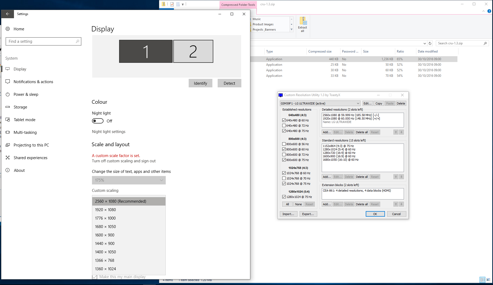

Hi Guys
I have an issue, I was using CRU to run multiple LG Ultrawide displays (1080 x 2560), one is connected via DVI and the other HDMI. The HMDI Connected one has always worked in full res through windows display settings, but the other always tried to run 1080 x 1920 streched across the monitor. Ive been using CRU for months to run both in 1080 x 2560, but since the windows update which I installed friday, the second monitor (DVI) has gone back to displaying in streched 1080 x 1920 and i cant seem to get CRU to over ride this? Any Ideas Cheers Kieran |

(07-24-2017 10:50 AM)crucialkieran Wrote: I have an issue, I was using CRU to run multiple LG Ultrawide displays (1080 x 2560), one is connected via DVI and the other HDMI.What video card do you have? What model are these monitors? You shouldn't have to add 2560x1080. It should already be there if the monitor supports it with DVI. |

(07-25-2017 12:14 AM)ToastyX Wrote:(07-24-2017 10:50 AM)crucialkieran Wrote: I have an issue, I was using CRU to run multiple LG Ultrawide displays (1080 x 2560), one is connected via DVI and the other HDMI.What video card do you have? What model are these monitors? You shouldn't have to add 2560x1080. It should already be there if the monitor supports it with DVI. Monitor 1 that runs through the HDMI has always had 2560 x 1080 available as a resolution in the windows settings, the second on that used the DVI has never had that option in the widnows settings, which is why I downloaded CRU as a fix. It has worked for months so the video card/cable definetley supports it, it is only since the most recent windows update it has stopped wroking. My video card is a Radeon HD 6570, I have attached two screenshots as reference, showing each screen in windows settings and CRU. Any advice would be appreciated. Thanks Kieran |
