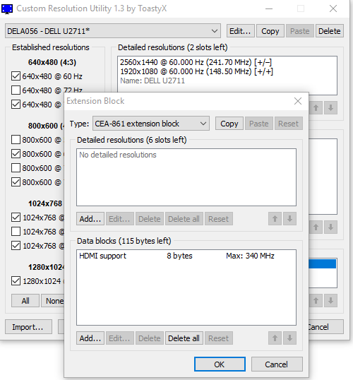

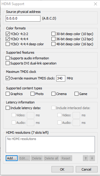

Post: #3081
(08-17-2017 06:37 AM)ToastyX Wrote:
(08-16-2017 06:12 PM)Chrismartin76 Wrote:  Thanks!
Under Device Manager, I have Intel HD Graphics 630 and NVIDIA GeForce GTX 1050. Both are currently enabled. I have Windows 10. The first detailed resolution is the same resolution (2560x1404) but 59.002 Hz. I also installed the HDMI extension block and the first detailed resolution there is 2560x1440 @ 59.950 Hz. When I installed the extension block, I kept the default settings because I don't understand what exactly the extension block does.
I just changed the refresh rate on both to 60.000 Hz and did a quick test. The monitor was OK after waking up. I'll post again if the problem recurs, but please let me know if I should do anything about the switchable graphics. Thanks!
I asked mainly because I was trying to find out what driver was responsible. This sounds like an Intel driver bug. I'm not familiar with Intel GPUs, so I don't know if there's a workaround. You shouldn't need to define the same resolution twice. Just having it as the first detailed resolution in the main window should be enough.
Usually the default extension block already includes HDMI support, but CRU can't read the extension blocks with Intel GPUs. If the default doesn't work, I was going to suggest importing hdmi-audio.dat, but it seems you're already trying a custom extension block.
OK I removed the second instance of the detailed resolution. The screenshots below are my settings on the main dialog and the block dialog. I don't want HDMI audio support at the moment, so I used hdmi.dat rather than hdmi-audio.dat.

08-18-2017, 09:58 AM
Post: #3084
(08-17-2017 03:54 PM)Chrismartin76 Wrote:  OK I removed the second instance of the detailed resolution. The screenshots below are my settings on the main dialog and the block dialog. I don't want HDMI audio support at the moment, so I used hdmi.dat rather than hdmi-audio.dat.
That looks fine. That should be enough to get 2560x1440 @ 60 Hz with HDMI. I noticed in your screen shot that the monitor list is missing the "(active)" status next to the *. I don't know if this is related to your problem or if it's just an Intel driver limitation.

08-18-2017, 03:37 PM
Post: #3086
Thanks. I happened to take the screenshots when I was working at a coffee shop so I wasn't connected to the bigger monitor.
