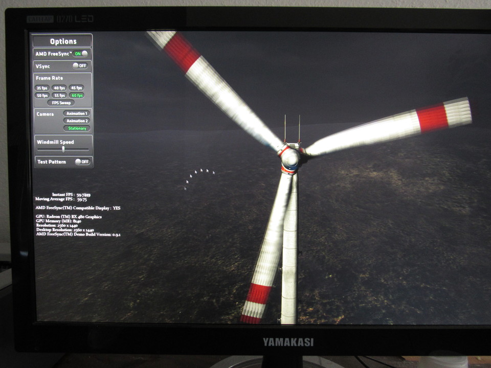

Update:
ToastyX Wrote:Okay, I got FreeSync working with the Catleap without a splitter. The HDMI support data block trick still works with the RX 480, but for some reason, I have to unplug the monitor from the DVI port and plug it back in before it's detected as HDMI. Then it will let me enable FreeSync. The problem is if I restart the driver or reboot, it goes back to detecting the monitor as DVI and disables FreeSync. |

Test results:
ToastyX Wrote:I found a way to show FreeSync is working. I noticed the refresh rate changes are also affecting the mouse cursor. I think this is the most convincing evidence that it's working because the mouse cursor works independently of the demo. |

(10-09-2016 01:31 PM)Screemer Wrote: Holy shit that sounds great. Die you think you get it working without having to unplug and maintain the function after a restart? That would be so great for all users of korean monitors.This is something AMD would need to fix, or the driver would have to be hacked, which wouldn't be easy. All of the monitor redetection methods I tried didn't work with the RX 480. This might not affect all video cards. (10-09-2016 01:31 PM)Screemer Wrote: I got a xstar dp2710 which is identical to the gerne common qn2710 by qnix. It sports a samsung panal and not a lg like the catleap. I am going to test it as soon as i get home. Is the hdmi 2.0 datablock needed as well or is the standard hdmi block enough?You only need the standard HDMI support data block. Keep in mind HDMI limits you to single-link data rates, so keep the maximum refresh rate around 60 Hz. I recommend trying 24-61 Hz so 60 Hz is included. This is what I have:
