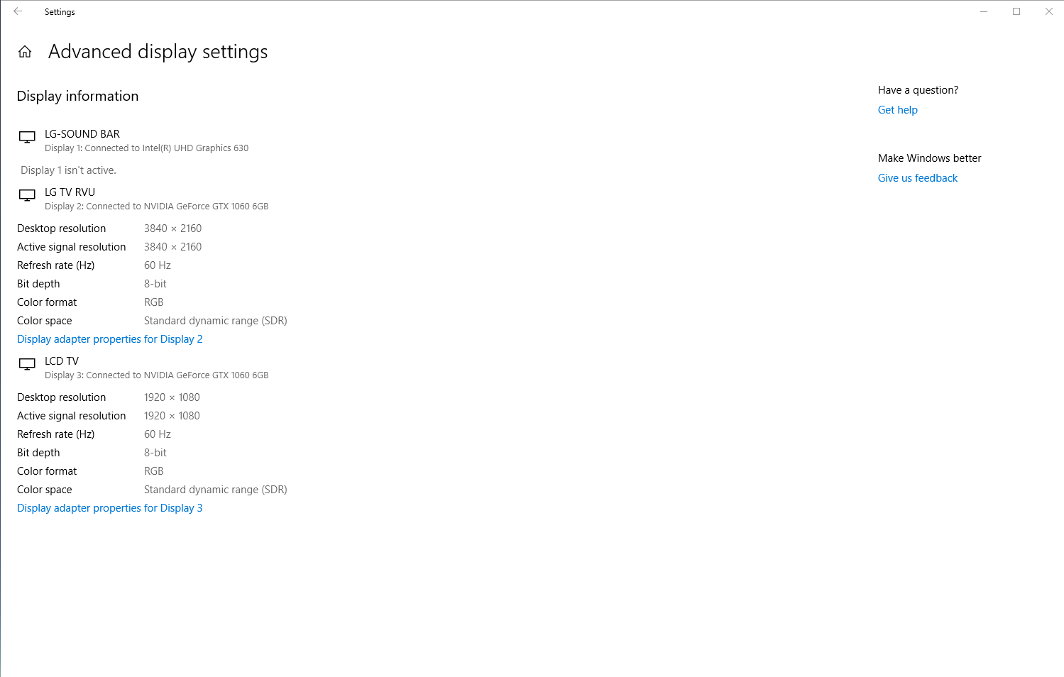

12-14-2018, 06:33 PM (Last edited: 12-14-2018, 06:44 PM by ToastyX)
Post: #3689
(12-14-2018 10:11 AM)Loz702 Wrote:  Oh gee, i repeat
MY LAPTOP DOES SUPPORT HDMI 2.0...
i did say what my graphics card is, intel HD graphics 4600, and its using the latest driver.
My computer is up to date, im not like the other 99% of PC users out there who dont know what their computer does, or alike...
Im a Microsoft Certified Engineer, who passed his A+ Cert 2 decades ago.. so compared to the users here, im a power use of a PC.
even MSI has confirmed.
The only thing I can put it down to is your software doesnt work on my computer. as it will not add any more resolutions to the drop down and i asked for help on how to do it correctly since there isnt any set of instructions to follow
You're not listening. It's possible CRU won't work with your GPU, but the underlying problem has nothing to do with CRU. This is a driver issue. You don't understand pixel clock limitations. The driver thinks your laptop doesn't support HDMI 2.0 and is not allowing higher pixel clocks. If it did, you'd be getting 3840x2160 @ 60 Hz automatically without doing anything. You shouldn't have to add resolutions that the monitor already defines. That indicates a problem. CRU can't force resolutions to work. It only tells the driver what resolutions the monitor supports using EDID overrides. If the driver doesn't support EDID overrides for your GPU, then CRU will have no effect. You can check by adding a lower resolution or refresh rate. If the driver supports EDID overrides but won't allow a higher resolution or refresh rate, then the problem is either the hardware doesn't support it, OR the driver wrongly thinks the hardware can't support it.
