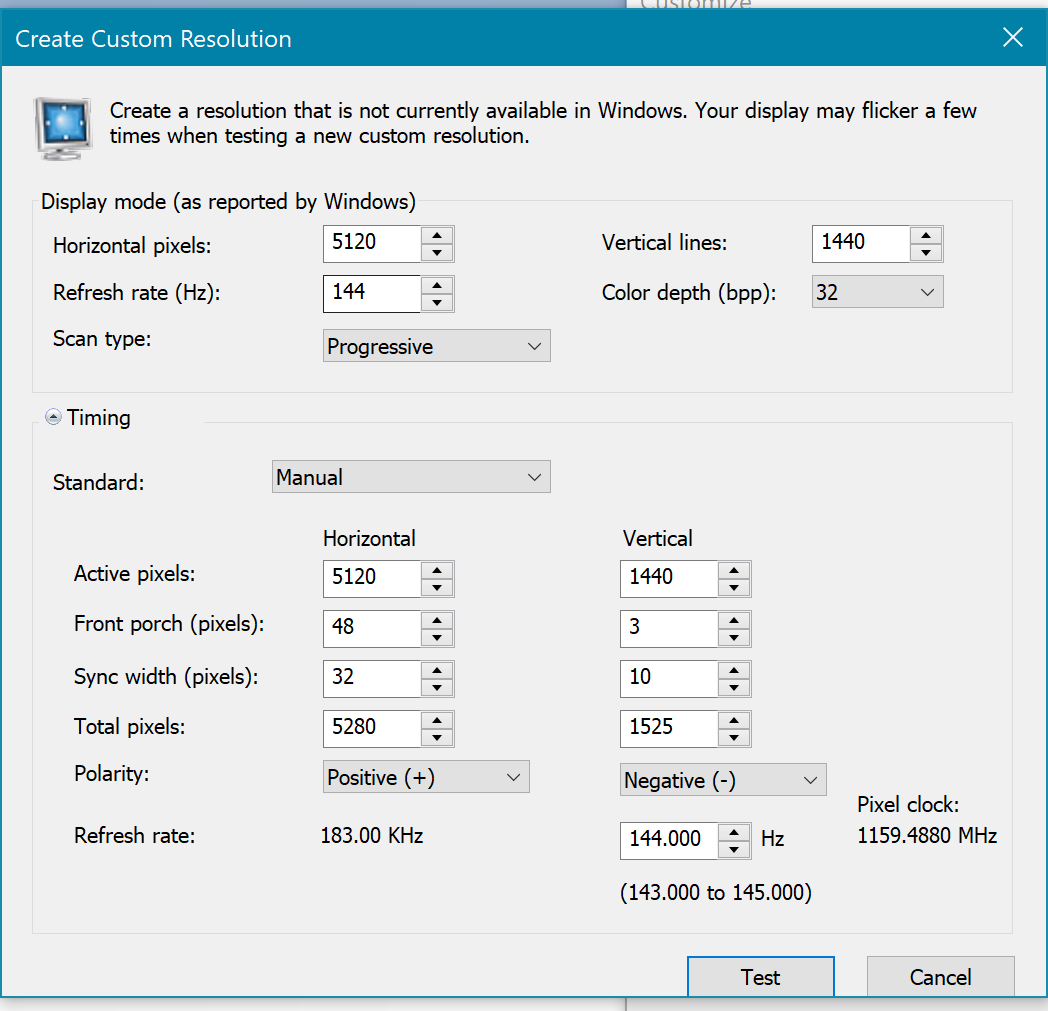

06-27-2020, 01:57 AM (Last edited: 06-27-2020, 01:59 AM by Azazel)
Post: #4905
Hi, I asked a question "Does anyone own the Samsung CRG9, or another Super Ultrawide like it? If so, can you post me what timings you used." But no one responded. I assume no one here has this kind of monitor or similar.
Can you help me teak the settings to get 144hz stable? I haven't messed around with the timings. I'm not as used to tuning timings at this resolution using display port 1.4. 144hz works right off the bat but with missing frames. This is using the Nvidia control panel only, Freesync off. Haven't used cru. Don't know if that would make much a of a difference. Don't know if overdrive should be on or off? Also wanted to know if it was possible to get 165hz at 6bits with the bandwidth Display Port 1.4 provides at my native resolution (5120x1440p)?
it is claimed by other people who own it that it can do 144hz no probs at it's native resolution. When I select it, it does set it without issues, but when I run the ufo test there are skipped frames. So something tells me it could be down to a timing issue? Any suggestions to tweak it would be helpful?
8bpc = blank screen. Still under the required 1080hz needed for 8-bit 144hz 5120x1440p
Default timings = works, but 6bpc, frame skipping.

Post: #4907
(06-27-2020 01:57 AM)Azazel Wrote:  it is claimed by other people who own it that it can do 144hz no probs at it's native resolution. When I select it, it does set it without issues, but when I run the ufo test there are skipped frames. So something tells me it could be down to a timing issue? Any suggestions to tweak it would be helpful?
No, timing parameters have nothing to do with skipped frames.
