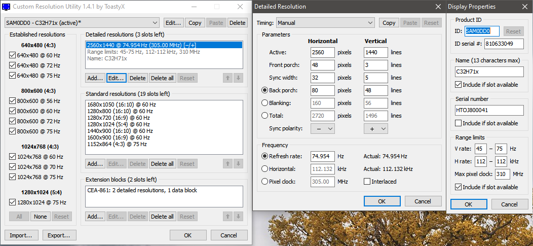

Hi ToastyX!
Need help from experienced people here.
Year or so I have used CRU to modify edid info to force idle VRAM clocks down (at default they stayed always max).
But recently i have encoutered weird and annoying GPU behavior. When monitor in stand-by state, after timeout (20 min), i am unable to wake it up with keyboard/mouse. Just heard one sound (just as when new device connected, not two as it should) and that's all. The monitor just showing black screen with horizontal bars sometimes flicker.
The only way one may wake it up is turn OFF/ON the monitor. When i change timings such way, that MCLK is back to max (1750Mhz) - the original behavior is back, i.e. the monitor wakes up when kb/mouse event occured.
If there's a way to aviod choosing from either working monitor power saver function or 200Mhz idle MCLK clock ?
Thanks!
Monitor Samsung C32H711 - connected via DP cable. CRU settings below
Drivers 20.7.2
PS: Sorry, edited for inaccuracy found describing a matter
08-02-2020, 01:38 PM
Post: #5023
(08-02-2020 01:05 PM)pj-2020 Wrote:  Hi ToastyX!
But recently i have encoutered weird and annoying GPU behavior. When monitor in stand-by state, after timeout (20 min), i am unable to wake it up. Just heard one sound (just as when new device connected, not two as it should) and that's all. The monitor just showing black screen with horizontal bars sometimes flicker.
The only way one may wake it up is when i change timings such way, that MCLK is back to max (1750Mhz)
Thanks!
That shouldn't happen unless there's a driver bug.
