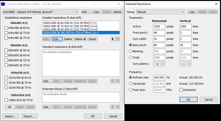

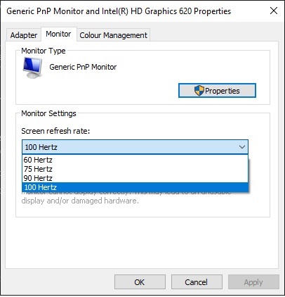

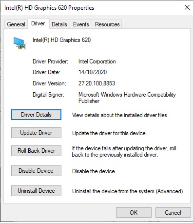

Succesful 100hz without any glitch, black bars or wrong colour
Hp 15-au11nt
Gpu : 7200u with Hd620 Gpu
Latest 27.20.100.8853 driver
Monitor : AUO40ED
Thanks for CRU developer. I feel so fluent. Cool
