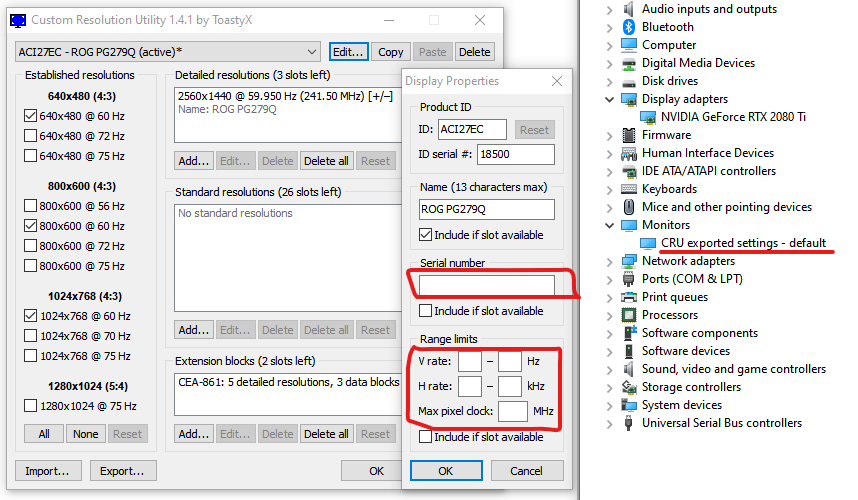

I've run reset-all, restarted the GPU, and installed test.inf.
Then NVCPL did not work.
After I restarted GPU, NVCPL still didn't work.
In the attached image, I show how CRU and Dev manager displayed things after test.inf is properly loaded.
Note: I installed INF file using Windows only, and updated Monitor driver using Device Manager. I only opened CRU to show you how it displays things after inf is loaded.

(11-01-2020 12:23 AM)botounacruzeta Wrote:  Note: I installed INF file using Windows only, and updated Monitor driver using Device Manager. I only opened CRU to show you how it displays things after inf is loaded.
This is frustrating because I can't pinpoint any particular change that is triggering the problem.
Are you sure about this:
(10-31-2020 08:13 PM)botounacruzeta Wrote:  I could also open NVCPL after doing these simple steps:
-run reset-all.exe;
-restart GPU;
-In CRU, enable both "Include if slot available" options under "Range limits" and under "Serial number";
-import the CRU-exported settings (default ones) using CRU;
-restart GPU;
Importing the file should disable both the range limits and serial number since they aren't included in the file, so it should be exactly the same as just importing the file. You also said choosing "Import complete EDID" worked alone, but that shouldn't make any difference because there weren't any changes made to the non-imported parts. You also said enabling the range limits and serial number worked after installing the MonInfo .inf file and importing the CRU-exported settings, but then CRU would just make the same changes that it would without installing the .inf file.
What happens if you use Device Manager and right-click and choose "Scan for hardware changes" after restarting the driver?
The only other thing I can think of is try using DDU: https://www.wagnardsoft.com/display-driv...aller-ddu-
Then reinstall the driver, and try the non-DCH drivers.
11-01-2020, 04:22 AM
Post: #5268
-run reset-all.exe;
-restart GPU;
-restart GPU;
Yes, doing these steps allow NVCPL to work.
(11-01-2020 02:01 AM)ToastyX Wrote:  You also said enabling the range limits and serial number worked after installing the MonInfo .inf file and importing the CRU-exported settings, but then CRU would just make the same changes that it would without installing the .inf file.
Well, the above steps I did without installing the MonInfo .inf file, and it worked.
If I reset-all.exe, restart GPU, and import the CRU-exported settings, it works; (CRU doesn't show "(active) *", probably indicating nothing was changed)
If I reset-all.exe, restart GPU, delete a detailed resolution (using CRU), restart GPU, and import the CRU-exported settings ("Import complete EDID" either enabled or not), it doesn't work; (CRU shows "(active) *", probably indicating nothing was changed)
Where does CRU saves the settings? To registry?
I thought it could be a good idea to use CRU to import CRU-exported settings (default), save the registry entry, and then change something using CRU, re-import CRU-exported settings (default), and compare registry in both cases. Shouldn't they be the same, as in both cases, CRU imported the same file?
If you can tell me the registry values it updates, I'd gladly test it.
(11-01-2020 02:01 AM)ToastyX Wrote:  What happens if you use Device Manager and right-click and choose "Scan for hardware changes" after restarting the driver?
Device Manager only refreshes its view, and the monitor retains its name.
(11-01-2020 02:01 AM)ToastyX Wrote:  The only other thing I can think of is try using DDU: https://www.wagnardsoft.com/display-driv...aller-ddu-
I'll try to do some more debugging before trying this, as it was a terrible experience installing the standard (non-DCH) drivers the last time I tried.

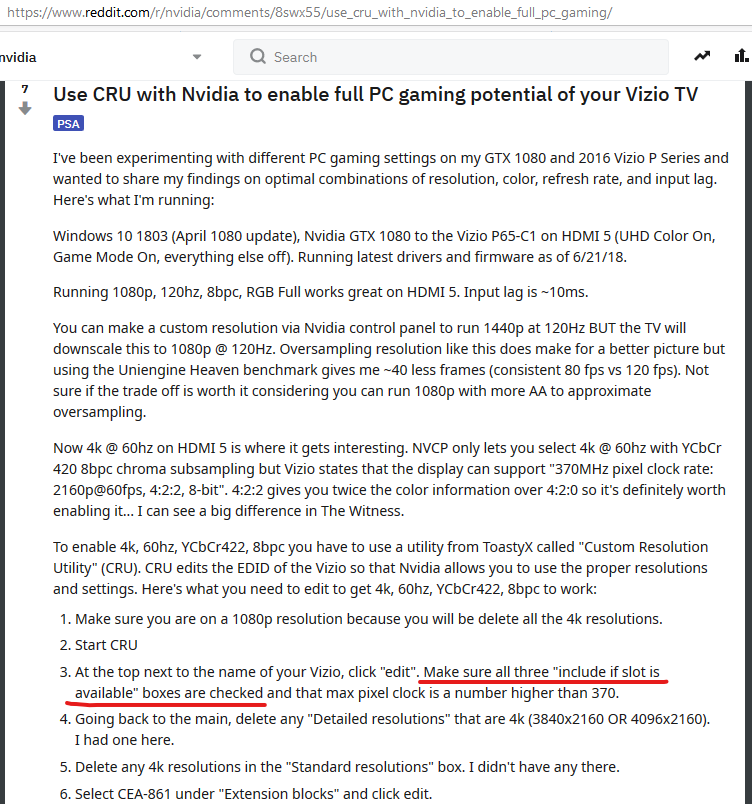

Yes, the problem is the first time I did it, I've enabled "Include if slot available" under "Range limits" and under "Serial number". I thought it was standard CRU procedure, that's why I didn't mentioned it before, sorry.
I'd read this tutorial
before using CRU, so I thought it was always needed.
