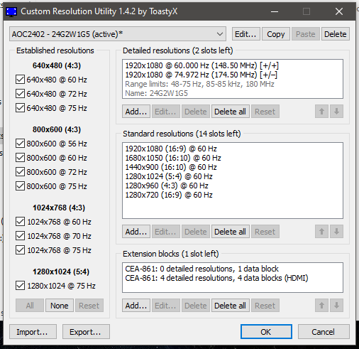

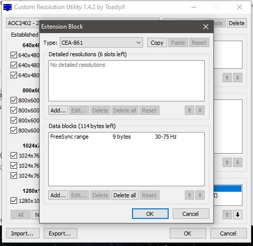

(12-21-2020 12:56 PM)ToastyX Wrote:  The data block was meant for HDMI FreeSync, but NVIDIA's driver seems to listen to it with DisplayPort.
Still does not work, and now it does not work even before the reboot. Probably it is a driver bug after all. That's what I did, in the screenshots..
12-21-2020, 03:01 PM
Post: #5492
(12-21-2020 02:46 PM)ioannis Wrote:  Still does not work, and now it does not work even before the reboot. Probably it is a driver bug after all. That's what I did, in the screenshots..
Do it both ways, and don't add an extension block. Put it in the existing extension block. If there's no room, you can delete the HDMI data block because it's not needed with DisplayPort.
12-21-2020, 03:23 PM
Post: #5493
Sadly it does not work. If i set it in the extension block (in the existing one) it does not work at all. If I set it above, in the display port section it works but resets after I reboot. It's fine though, thanks a lot for the help anyway!!
