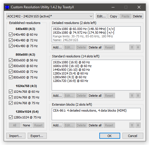

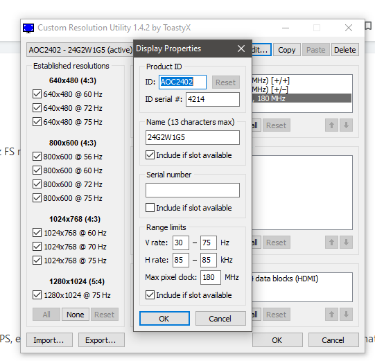

Hello and congrats on this great utility! I've managed to lower my freesync limits from 48-75 to 30-75 but on every reboot it gets backs to 48-75 even though on CRU it says 30-75 (i can see it in games that is in fact 48-75). I have an RTX 2060. I include two screenshots of how I did the settings. Thanks!
12-21-2020, 01:55 AM
Post: #5488
(12-20-2020 06:01 PM)ioannis Wrote:  Hello and congrats on this great utility! I've managed to lower my freesync limits from 48-75 to 30-75 but on every reboot it gets backs to 48-75 even though on CRU it says 30-75 (i can see it in games that is in fact 48-75). I have an RTX 2060. I include two screenshots of how I did the settings. Thanks!
Does that mean it works after running restart64.exe but reverts after rebooting? That would mean a driver bug. Are you using DisplayPort or HDMI? Try adding a FreeSync range data block in the extension block and set the range there.

(12-21-2020 01:55 AM)ToastyX Wrote:  Does that mean it works after running restart64.exe but reverts after rebooting? That would mean a driver bug. Are you using DisplayPort or HDMI? Try adding a FreeSync range data block in the extension block and set the range there.
Yes it works as it should in the first place but after reboot it gets back to defaults. I am using a displayport. The extension block is used with HDMI?
12-21-2020, 12:56 PM
Post: #5490
(12-21-2020 07:17 AM)ioannis Wrote:  Yes it works as it should in the first place but after reboot it gets back to defaults. I am using a displayport. The extension block is used with HDMI?
The data block was meant for HDMI FreeSync, but NVIDIA's driver seems to listen to it with DisplayPort.
