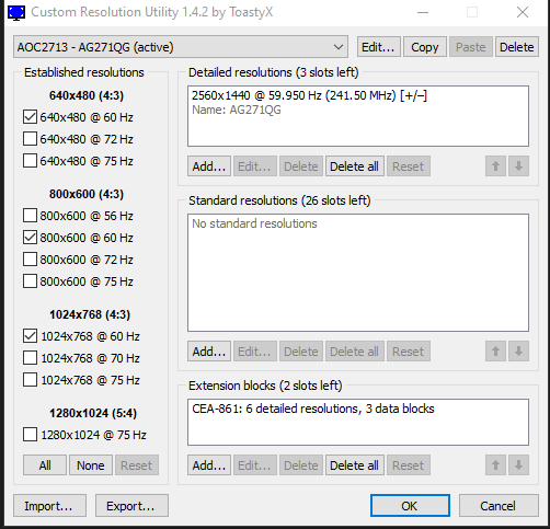

01-15-2021, 07:52 AM (Last edited: 01-15-2021, 08:39 AM by jordyn11)
Post: #5593
I have recently run into issue which I haven't been able to fin[Image: IfmzWGQ]d a solution for online. When I run DSR at 3840x2160 on my 2560x1440 165mhz monitor the majority of games will flicker then minimize to desktop upon launching. This has only recently started happening after I used CRU to reset my display devices after getting a new GPU (RTX3090) when previously there was no issues when using DSR. I have tried everything I have seen online including reinstalling drivers using DDU, deleting the Windows Display Cache and of course recently using CRU to reset the display devices.
I have attached the current CRU for the display which I notice only has 1 Detailed Resolution and no Standard resolutions.
Google has been no real help so I am wondering if any of the experts here have heard of this type of behavior and if there are any suggestions. Would really appreciate any advice.
Thanks in advance.

(01-15-2021 07:52 AM)jordyn11 Wrote:  I have recently run into issue which I haven't been able to fin[Image: IfmzWGQ]d a solution for online. When I run DSR at 3840x2160 on my 2560x1440 165mhz monitor the majority of games will flicker then minimize to desktop upon launching. This has only recently started happening after I used CRU to reset my display devices after getting a new GPU (RTX3090) when previously there was no issues when using DSR. I have tried everything I have seen online including reinstalling drivers using DDU, deleting the Windows Display Cache and of course recently using CRU to reset the display devices.
That sounds like a driver bug. Running reset-all.exe deletes the display cache and so does DDU, so it's not a Windows setting issue. Are you able to set the DSR resolution on the desktop? What about if you change the refresh rate?
01-15-2021, 09:23 PM
Post: #5597
Yes am able to set desktop to the the DSR resolution (although it looks slightly blurry due to scaling I guess). When changing refresh rate it still behaves the same as if the game can't get priority, flickering back and forth then minimizing,
