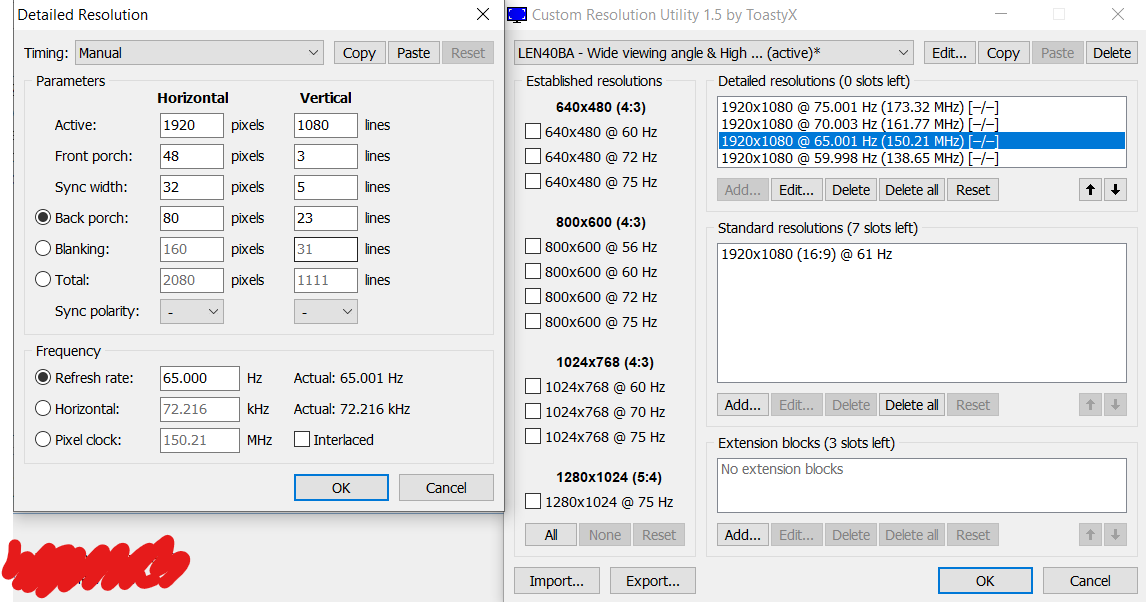

I have an Intel UHD Graphics 620, laptop with a 1920x1080, updated to the latest drivers. I ran CRU (administrator), to add a new detailed resolution, modifying the frame rate, while copy-pasting everything else from my default profile. I then ran restart64.exe, but could not find the new profile in the Intel Graphics Control Panel. Is my computer incapable of overclocking its panel? Or am I doing something else wrong?
I attached a screenshot below. |

(01-15-2021 04:11 AM)Bob321 Wrote: I have an Intel UHD Graphics 620, laptop with a 1920x1080, updated to the latest drivers. I ran CRU (administrator), to add a new detailed resolution, modifying the frame rate, while copy-pasting everything else from my default profile. I then ran restart64.exe, but could not find the new profile in the Intel Graphics Control Panel. Is my computer incapable of overclocking its panel? Or am I doing something else wrong?The driver seems to be ignoring the override. Try the alternative method. |
