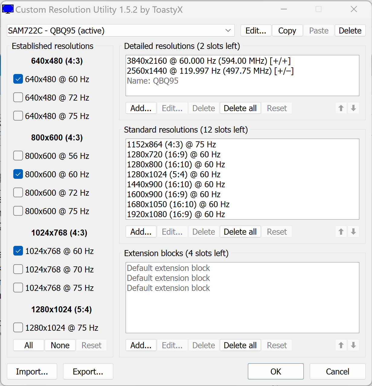

08-09-2023, 09:41 PM (Last edited: 08-09-2023, 10:04 PM by Soylent)
Post: #7563
Hello, I'm having a similar issue. I just upgraded from an Nvidia 2080 to a 3080 on my Windows 11 desktop, and now my Samsung QN95B TV will not work on anything except 144hz when Gaming Mode is enabled. I can change resolutions, but if I select 120hz or 100hz, I just get an HDMI disconnect screen. I noticed in CRU that when Gaming mode is enabled, there are 3 "Default Extension Blocks" in the Extension blocks section, but all 3 of them are empty. I'm not sure where it's even getting the 144hz from, but HDR 10-bit RGB and VRR seem to be working normally. However, if I disable Gaming mode CRU shows one entry for "CTA-861" with a bunch of settings in it, but with Gaming Mode disabled the maximum settings in Windows and NVCP is 60hz, no HDR, and only YCBCR444 color. It certainly should be able to do 120hz and HDR without Gaming Mode enabled.
My previous card, the 2080, didn't have any of these issues with this TV. Other than it being HDMI 2.0 so I couldn't get 4K@120hz, but 4K@60hz and 1440@120hz worked flawlessly with HDR 8-bit and VRR enabled. It seems like the only change is going from HDMI 2.0 to 2.1.
I've tried doing a clean install of the nvidia drivers and reset-all in CRU. The HDMI cable itself might be defective or only 2.0, but if that was the case I don't think 4K@144hz would work at all. I'm only using it in Gaming Mode, but being stuck in 144hz is causing issues with some games that have hardcoded video settings. Any ideas?

08-10-2023, 04:57 AM
Post: #7564
(08-09-2023 09:41 PM)Soylent Wrote:  Hello, I'm having a similar issue. I just upgraded from an Nvidia 2080 to a 3080 on my Windows 11 desktop, and now my Samsung QN95B TV will not work on anything except 144hz when Gaming Mode is enabled. I can change resolutions, but if I select 120hz or 100hz, I just get an HDMI disconnect screen. I noticed in CRU that when Gaming mode is enabled, there are 3 "Default Extension Blocks" in the Extension blocks section, but all 3 of them are empty. I'm not sure where it's even getting the 144hz from, but HDR 10-bit RGB and VRR seem to be working normally. However, if I disable Gaming mode CRU shows one entry for "CTA-861" with a bunch of settings in it, but with Gaming Mode disabled the maximum settings in Windows and NVCP is 60hz, no HDR, and only YCBCR444 color. It certainly should be able to do 120hz and HDR without Gaming Mode enabled.
I had the exact same problem on my S95C. I initially thought the TV was defective and was considering returning it. I also have an RTX 3090. However, I managed to solve the issue by changing the HDMI cable. The cable that wasn't "working" was 3.05 meters long. I replaced it with a nearly identical one (both were Amazon Basics certified for 8K@60 at 48 Gbps), but this one was only 1.8 meters long. That did the trick, and it started working properly. Another thing you should check is the Nvidia control panel and ensure that the scaling is set to "Display." If it's set to "GPU," the video card will only output at 144Hz. Please verify these settings and let me know.

08-11-2023, 01:04 AM
Post: #7567
The issue you're having is unrelated to CRU not being able to read the extension blocks. There's some NVIDIA-specific driver limitation involved, probably the GPU scaling issue that Ronyn77 mentioned because NVIDIA can't scale with DSC.
