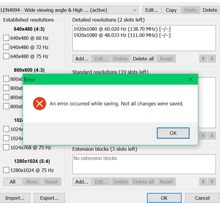

Hi there,
I have a problem regarding the CRU software; whenever I try to add/save a custom refresh rate and click "OK" to apply, it says "An error occurred while saving. Not all changes were saved" and immediately closes the program when I press "OK". Is there a way to fix this? I use an Intel graphics card and restarting my computer doesn't help either. If anyone can find a fix to my problem is well appreciated. Thanks!
