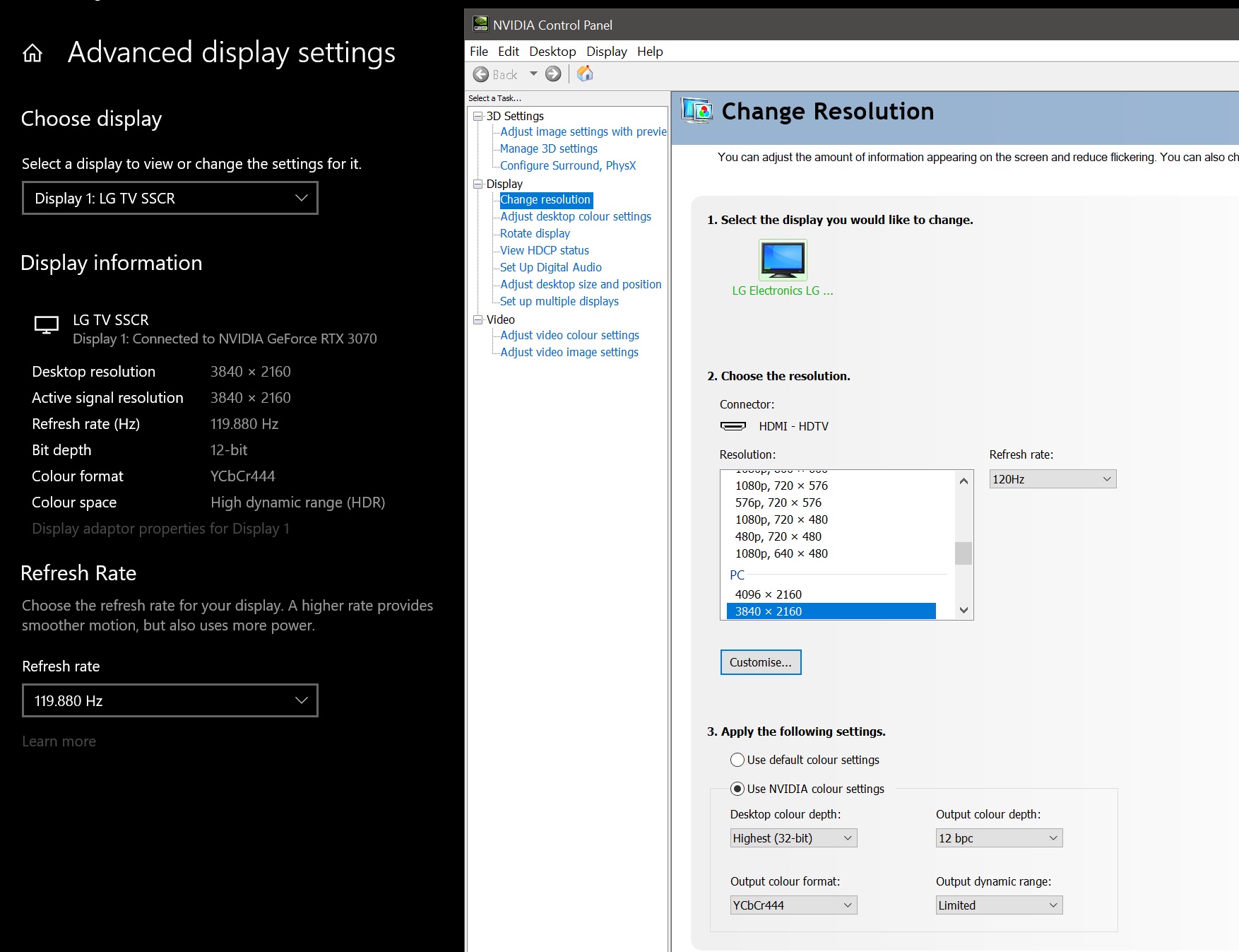

12-09-2020, 03:58 PM (Last edited: 12-09-2020, 04:01 PM by traderdude123)
Post: #5409
(12-09-2020 03:18 PM)ToastyX Wrote:
(12-09-2020 08:34 AM)traderdude123 Wrote:  can you tell me if the TV can support 4k/100hz/ycbcr444/12bpc from this file?
if the TV can support it , then its clearly a driver issue. Then the ball falls in the nvidia's court.
Oh, I do see something that would limit the maximum FRL rate to 40 Gbps. I didn't know what that was for because I don't have the HDMI 2.1 specs, but your comment about FRL helped me make the connection. CRU doesn't have a way to edit any of the HDMI 2.1 features yet, but it can import the changes.
Try importing this file:
@toastyx,
I cannot believe what just happened.I imported the lg-cx-48gbps.dat file.
I m getting 4k/120hz/ycbcr444/12bpc on my lg cx which has only 40Gbps.
but 4k/120hz/ycbcr444/12bpc requires full 48 gbps.
How is this even possible?
See attachment.
Edit: even the TV hdmi stat info is showing 4k/120hz/Ycbcr444 12b 4L12
12-09-2020, 04:22 PM
Post: #5410
(12-09-2020 03:58 PM)traderdude123 Wrote:  I cannot believe what just happened.I imported the lg-cx-48gbps.dat file.
I changed the max to 48 Gbps (12 x 4 lanes). A future version of CRU will be able to edit the value. Sometimes TVs will support features that aren't listed in the EDID like higher refresh rates or color formats. I didn't know what the FRL rate was for until now.
