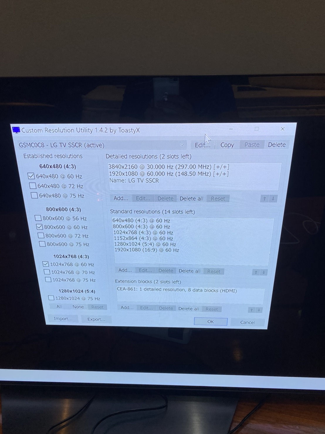

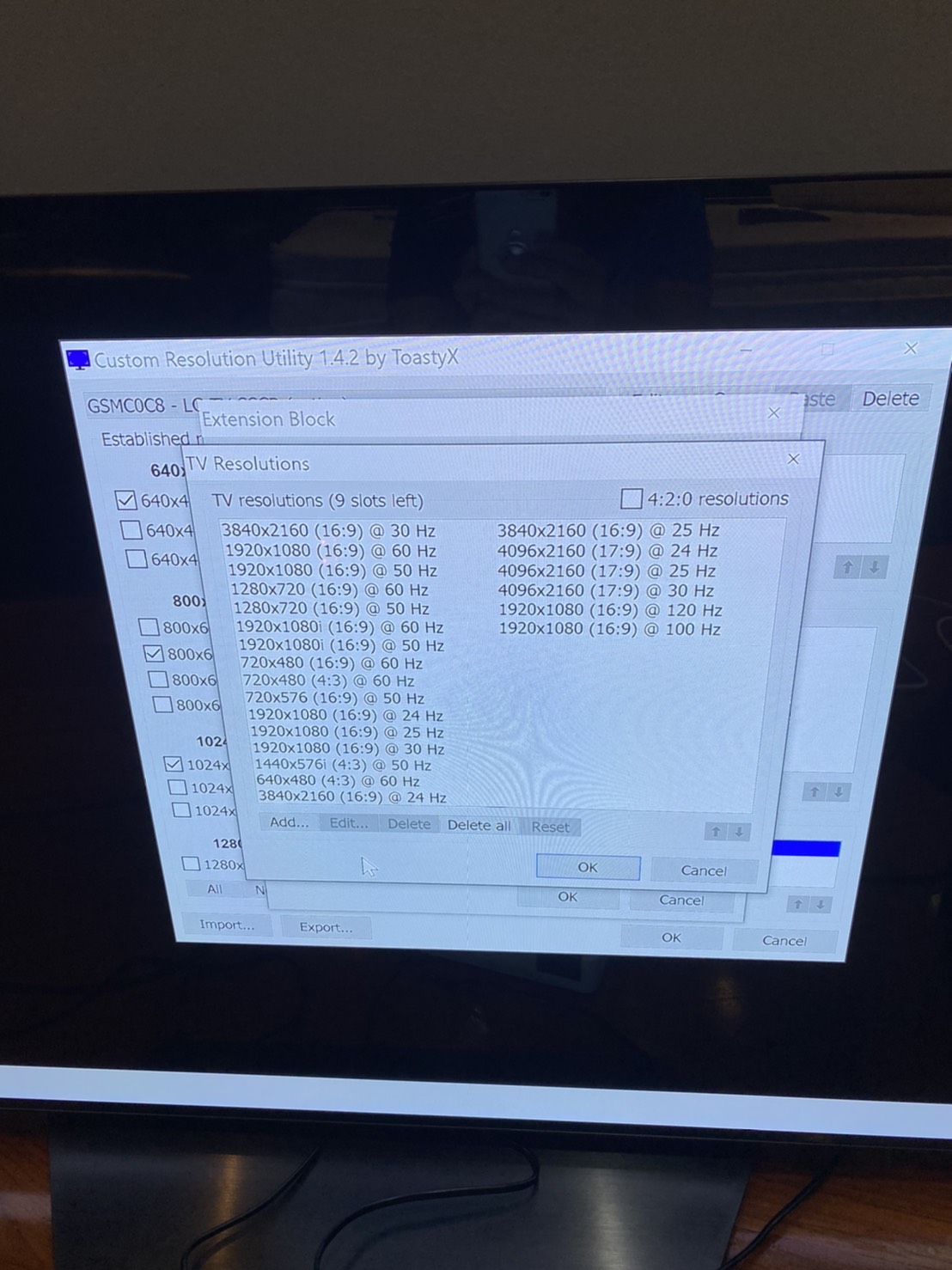

Hi ToastyX and everyone, help me
I just buy three LG CX48 for sim racing. I never use triple monitor before. After I run Nvidia Surround, it does not work. There is only one resolution I can choose which is 12288x2160. After I apply, only one work with weird resolution. However, two others have no signal. I find solutions on YouTube that how I know CRU. I try to solve the problem step by step
https://www.youtube.com/watch?v=9PatN3WYoEo
https://www.youtube.com/watch?v=vAjV40CnAeA&t=29s
However, it does not work. As a result, there is only one resolution I can choose which is 12288x2160. I do not know how to go on so please guild me how can I run Nvidia Surround with 5760x1080 or 7680x1440
Therefore, I attach 4 picture in here which are my computer spec and information of CX48 in CRU
PS. I use three normal display port to hdmi adaptor.
Sincerely
