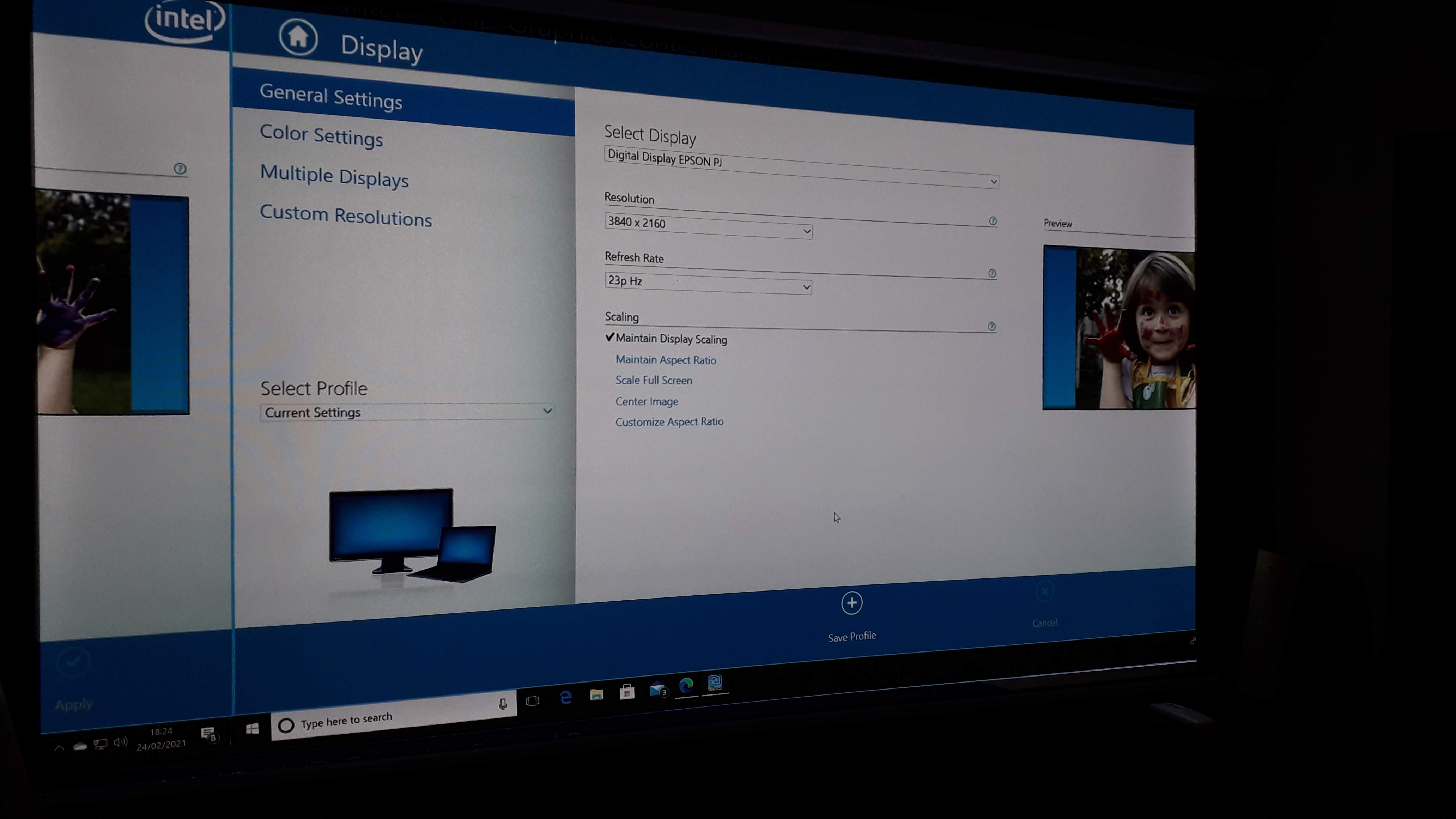

I've used CRU to great effect to fix windows 10 audio issues because of the intel driver not giving me audio because i use a projector. Customising the EDID allowed me to have full 5.1 sound. So thanks to the author for that.
I'm now trying to use CRU to correct a resolution issue when trying to set a resolution of 3840x2160 @24hz via HDMI from PC to projector. The issue as you can see from the attached images is what seems to be a timing issue as the images are topsy turvy. Sometimes bottom on top, sometimes off center. I'm using Intel 630 UHD graphics. Is there a way to correct this with custom timings? Thanks. |
