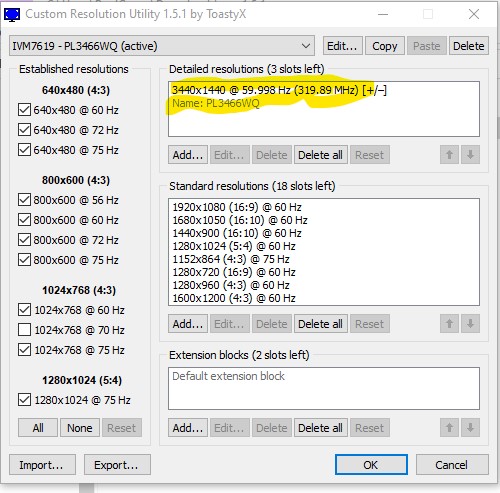

Hi guys,
I just bought a new monitor (Iiyama GB3466WQSU). This monitor should have a native resolution of 3440x1440, but I don't see it in Windows 10.
I tried this tool and it shows me the native resolution of the monitor as soon as I open the tool:
Do I need to do something to make it visible in Windows?

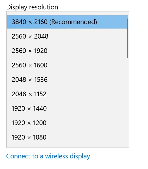

Because there it doesn't show me:
Many thanks!
