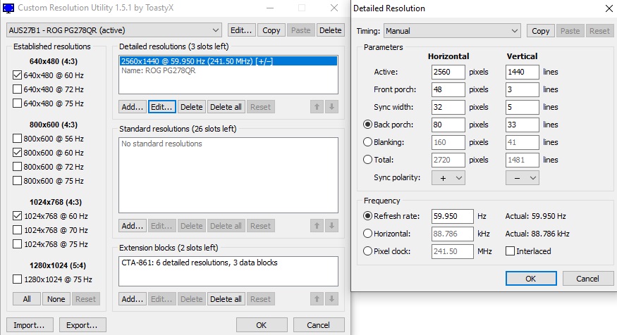

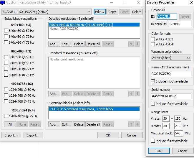

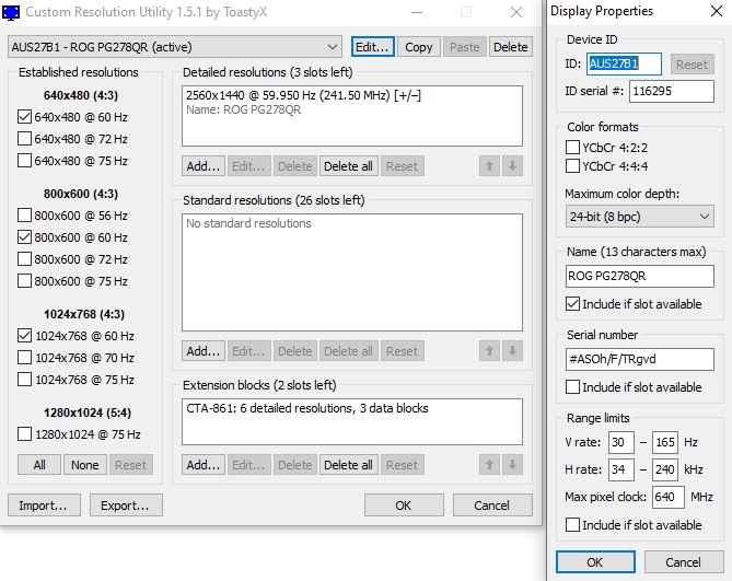

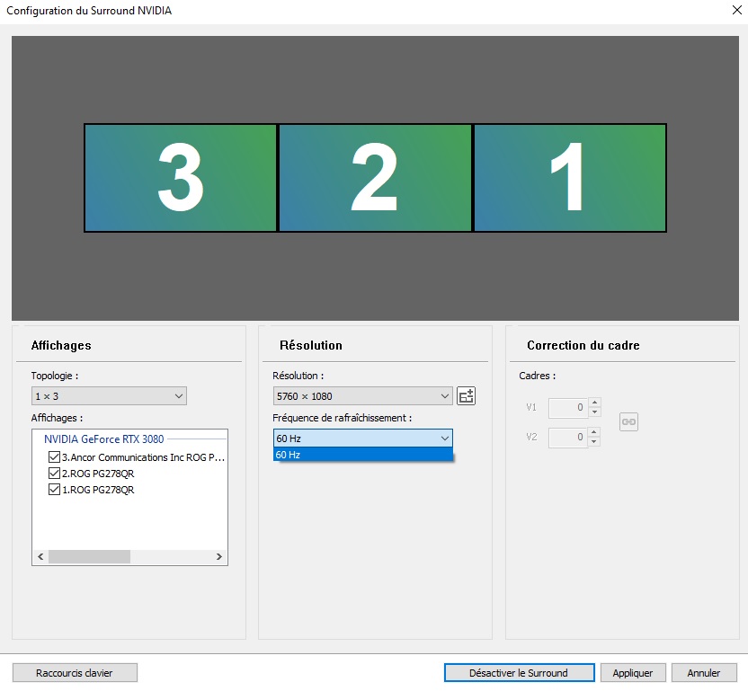

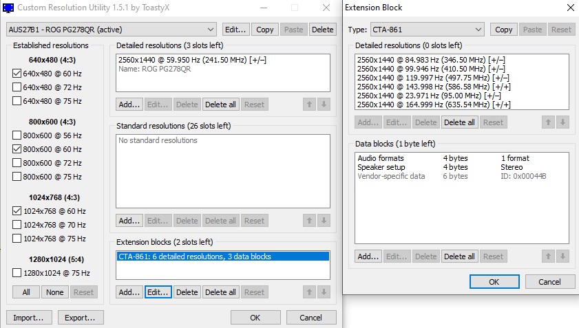

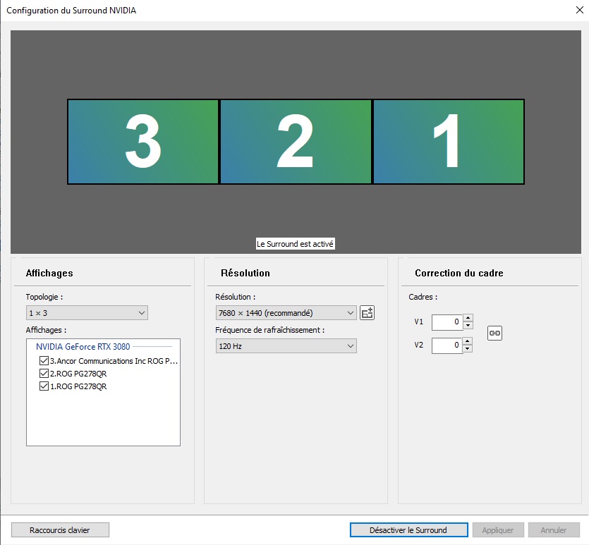

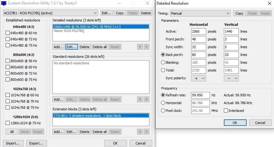

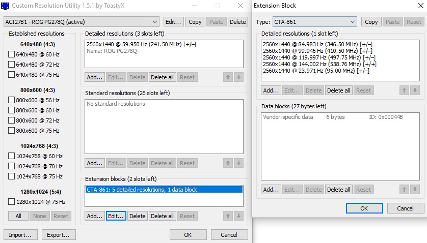

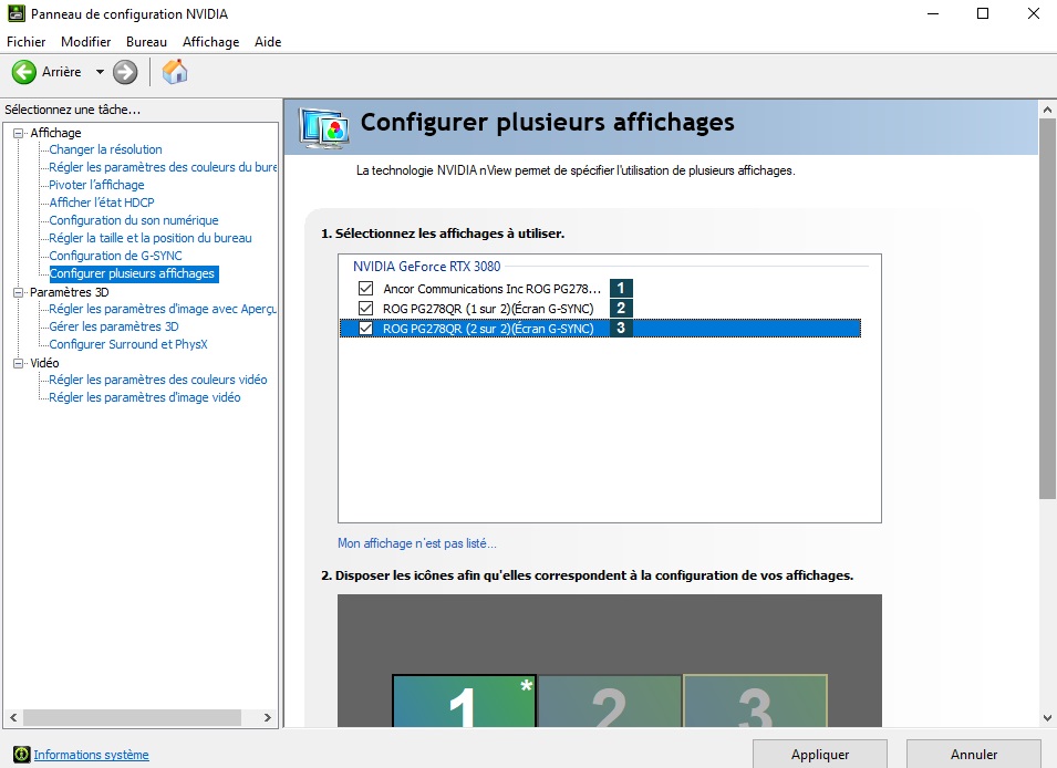

I use 3 monitors, 1 PG278Q (2560x1440 144hz), 1 PG278QR (2560x1440 165hz OC), 1 PG278QR (2560x1440 165hz OC).*
I use 3 displayports.
With Nvidia surround I can only have 7680x1440@ 120hz and 5760x1080@60hz.
Is it possible to use CRU to play at 7680x1440@144hz and 5760x1080@144zh ?
NVIDIA SURROUND
CRU detail for PG278Q
CRU detail for PG278QR (both same)

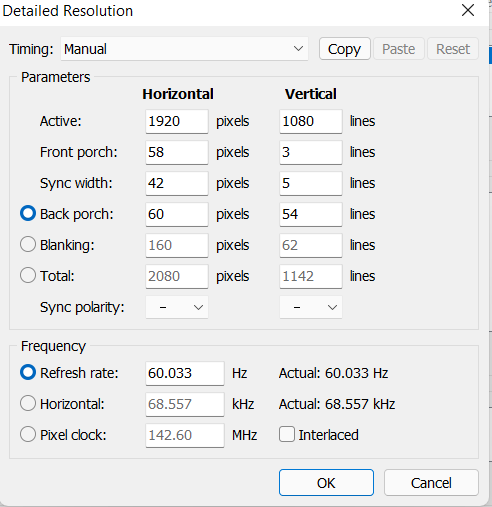

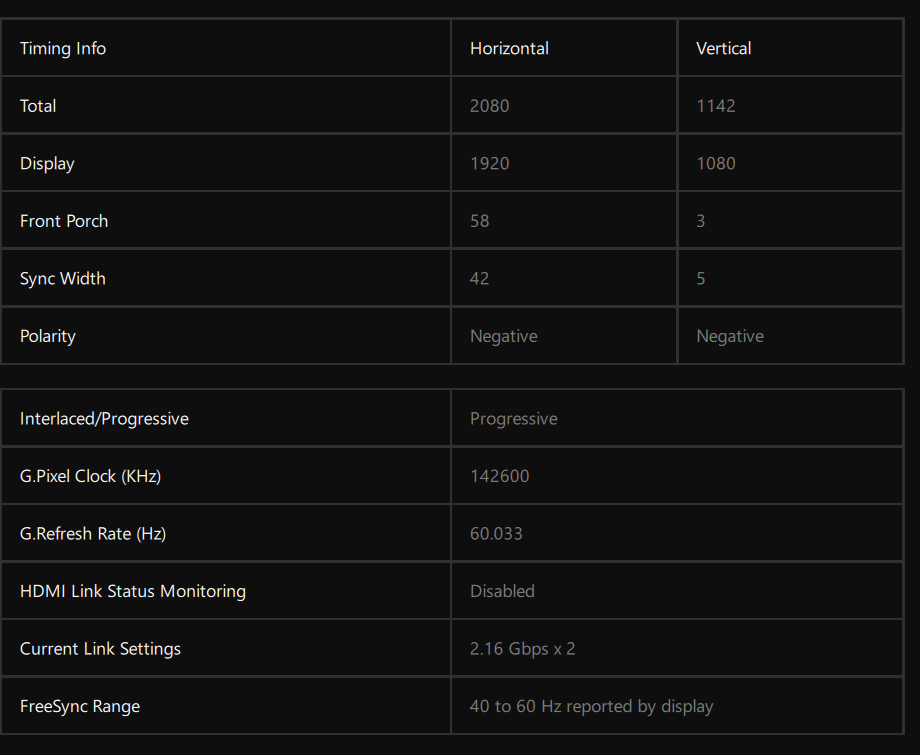

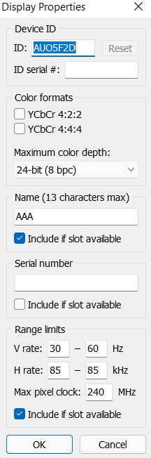

i have lenovo yoga 6 13 laptop with
- Ryzen 4500u
- AUO5F2D screen with 40-60hz freesync range.
any idea why i cant change the freesync range to 30-40hz? I've tested with custom resolution at 30hz and the monitor works fine.
the spec
i tried this in CRU, but still stuck with 40-60hz range
i copied the H rate and pixel clock from a tutorial someone posted on reddit, for a completely different monitor.
is my issue due to incorrect pixel clock and h rate? how to find the right values?
thank you
07-09-2021, 08:12 PM
Post: #5954
(07-09-2021 03:54 PM)orangpelupa Wrote:  i copied the H rate and pixel clock from a tutorial someone posted on reddit, for a completely different monitor.
The range limits is not the FreeSync range unless it's DisplayPort, in which case it would already be filled in. Use the HDMI method: add a CTA-861 extension block and add a FreeSync data block. You will also need a 40 Hz detailed resolution.

(07-08-2021 10:52 PM)Alex Wrote:  I use 3 monitors, 1 PG278Q (2560x1440 144hz), 1 PG278QR (2560x1440 165hz OC), 1 PG278QR (2560x1440 165hz OC).*
Yes, make the timing parameters and frequencies for 2560x1440 @ 144 Hz match exactly on all three monitors.

07-10-2021, 01:57 AM (Last edited: 07-10-2021, 02:11 AM by orangpelupa)
Post: #5958
I've added the freesync range (hdmi method) and it's still won't change the range.
Maybe because the screen is using eDP?
As the methods I've read are for DP and HDMI, but I can't find any for eDP
Edit: on a different laptop, someone managed to fiddle with freesync with a bin file it seems https://www.reddit.com/r/Amd/comments/a9...nt/ecj3714 but they didn't say anything what the bin file changes
