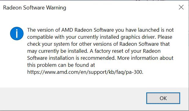

Hello, I'm getting the following error message for AMD Radeon software after trying to enable freesync with CRU.
[Image: PA300-1.png?itok=N0vY7wWl]
I have an Ryzen 4700U. Is this normal?
Thanks

(10-24-2021 11:33 AM)discokatt Wrote:  Hello, I'm getting the following error message for AMD Radeon software after trying to enable freesync with CRU.
https://www.amd.com/system/files/styles/...k=N0vY7wWl
No, that's not normal.
