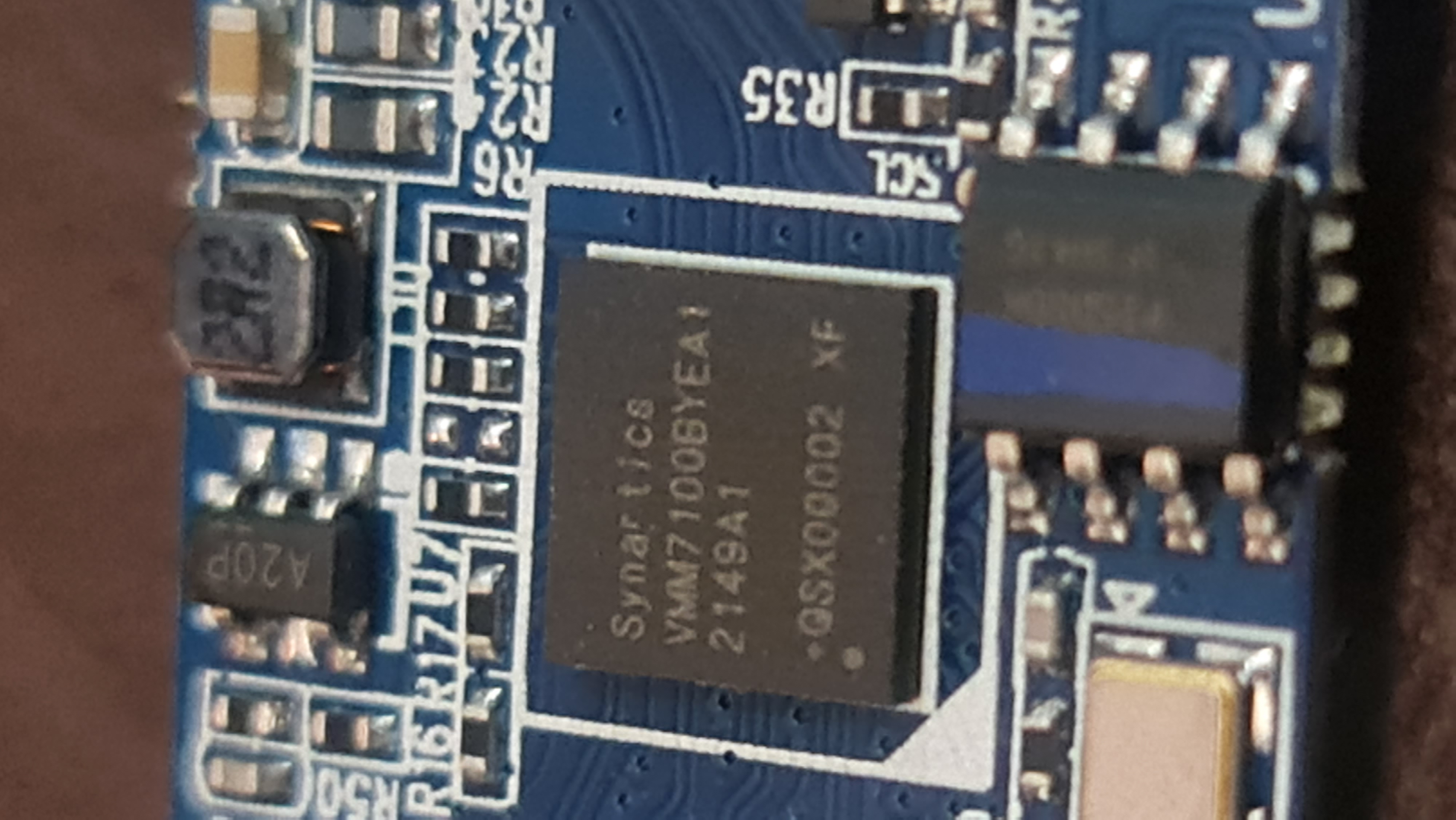

(05-19-2022 01:47 AM)ToastyX Wrote:(05-18-2022 06:17 AM)cluelessguy Wrote: Yes it does support forum VRR. Can I edit something in the EDID so I can force it?The VRR range is defined in the HDMI 2.x data block. If the TV supports HDMI VRR, it should already have a range defined, so something is not supporting the conversion. This is what I'm using for DP alt mode conversion. Could this be the culprit? |

(05-19-2022 04:03 AM)cluelessguy Wrote: This is what I'm using for DP alt mode conversion. Could this be the culprit?I don't know the capabilities of that chip. I saw a reply on reddit that says the Synaptics VMM7100 doesn't support VRR. Parade supposedly has a chip that does VRR (PS 196), but I don't know what uses it. |
