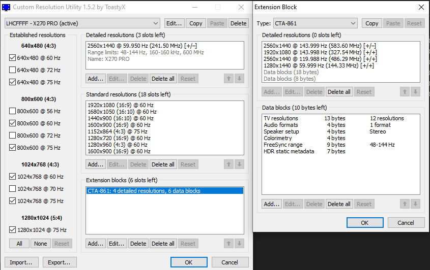

(09-18-2022 02:28 PM)ToastyX Wrote:(09-18-2022 02:05 AM)egagah Wrote: I have dual monitor setup and RTX2070super as below:Normally for the GPU to clock down with multiple monitors, both monitors have to be perfectly synchronized so the vertical blanking periods happen at the same time, but this is hard when the resolutions don't match. I don't know how it clocks down at 59.951 Hz because that doesn't match the other monitor exactly. Freezing would be an NVIDIA driver bug, but that might be happening if the monitor isn't staying connected properly. If the PRISM+ can't handle custom parameters, that makes it much more difficult to synchronize both monitors, and I can't even guarantee synchronizing them would allow the GPU to clock down because the driver might not handle all cases where the resolutions are different. If the PRISM+ can handle a very slight tweak to the timing parameters, making all the parameters and the pixel clock a multiple of 4 would allow making a 1920x1080 equivalent by multiplying the parameters by 0.75 and the pixel clock by 0.5625. Technically these two are perfectly synchronized: Hi Toast! Thanks so much for the detailed reply! So I tried the settings as per the screenshot, no problem when I changed the settings on the AOC display, even did a driver64 reset without issue. But the moment i change the settings for the prism+ display and do a driver64 reset, the entire PC freezes again. So I'm going to guess this is just signs that the PRISM+ monitor cannot be modified at all with CRU? Based on your experience, this is really a sign of the monitor issue or it's NVIDIA driver? Like idk how to find a good driver to test with haha. By the way, not sure if this is the right way, but I just modified the values in the detailed resolution itself (so for the AOC, changing the 144Hz profile to a 119,584Hz profile as per your screenshot, and the PRISM+ one 59.950Hz to the 119.584Hz profile). Every paramter like front back proch etc, i follow exactly as per the screenshots too. I also checked the standard resolutions + extension blocks, 1080p 120Hz doesn't exist in X270 pro. It does appear in the extension blocks for AOC monitor though EDIT: I got it to work using NVIDIA'S panel's built-in custom resolution! This is the settings used, hope it helps us understand more what went wrong haha. I want to say big thank you Toasty for your big support! |

(10-02-2022 04:20 AM)egagah Wrote: Hi Toast! Thanks so much for the detailed reply! So I tried the settings as per the screenshot, no problem when I changed the settings on the AOC display, even did a driver64 reset without issue. But the moment i change the settings for the prism+ display and do a driver64 reset, the entire PC freezes again. So I'm going to guess this is just signs that the PRISM+ monitor cannot be modified at all with CRU? Based on your experience, this is really a sign of the monitor issue or it's NVIDIA driver? Like idk how to find a good driver to test with haha.If any change causes the PC to freeze, then it's an NVIDIA driver bug. I've received sporadic reports of driver crashes since 471.41, but in those cases I didn't find anything unusual with the EDID, so I don't know what the trigger is. I only know of one driver bug that could cause a crash if the CTA-861 extension block doesn't have at least two bytes left for data blocks, which I noted in the first post. |
